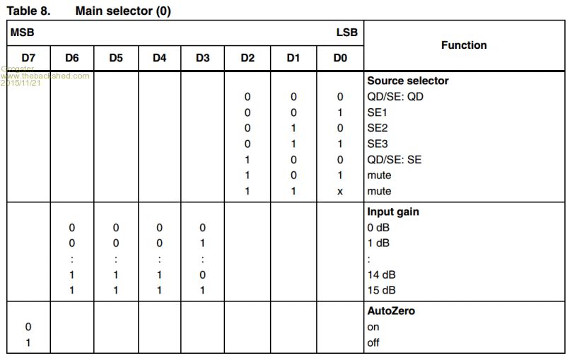

Take the following snippet from the manual:
As you can see, this byte consists of several things you can adjust, those being the input source selector, the input gain, and the AutoZero feature.
I understand how all this changes to get you what you want, but what I DON'T understand, is the mathematics behind how you manipulate the bits of the byte to get the final byte you send off to the device with the settings you want.
Take for example, the case of wanting SE1 input, 3dB input gain and AutoZero off.
This would result in a final byte of &B10011100, or 9Ch(156 decimal).
That's fine, and I follow all that just fine, but the problem I am having is in working out HOW you combine the values into the one byte.
jman used XOR, but I have played with XOR at the command prompt, but it does not render the results I expect, I am obviously not understanding how XOR works as well.
I post this here, rather then pester jman directly, as I thought it might make a useful public discussion, and a chance for others to learn the same thing I am trying to learn etc, etc, etc...
So, getting back to the above example, and going on what I do understand about how binary numbers are powers of two, you therefore have the following values for the byte:
AutoZero=80h(128 decimal)
Gain(3dB)=18h(24 decimal)
Input(SE)=04h(04 decimal)
Adding these together, we correctly come to 9Ch(156 decimal), and all this is fine, and I follow all that.
WHERE I AM LOST: Combining the numbers SIMPLY. You can, naturally, add the numbers up, but if you have to set bit7 in one command, and bits 4 & 5 in another command, and then COMBINE both those into ONE byte, WITHOUT upsetting the bit-positioning of any previous command - this is where I am lost.
Not sure I am explaining it that well, as I don't understand the mathematics involved, so am probably using the wrong terms, but hopefully everyone can see what I mean.
A very simplistic am mathematically incorrect way of demonstrating the above is that you have two bytes in the form of A=&B10000000 and B=&B00011000 - how do you combine those so that you end up with a single byte equal to &B10011000? A XOR B does NOT return the correct result(298h or 664 dec), so I am unwilling to trust this blindly, even though this is how jman is doing some of it.

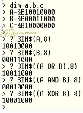

When working with bits it is best to use BIN as you are doing.
You need to understand the basic BIT operations - AND OR and XOR
AND, if both bits are set (1), the result is 1
OR if either bit is set, the result is 1
XOR if one bit is set (1) and the other not set (0), the result is 1
There is no 'carry' and the operation is done on each bit independently.
try this code:
A=&B10010000
B=&B00011000
C=&B01000000
PRINT BIN$(a,8)
PRINT BIN$(b,8)
PRINT BIN$(c,8)
PRINT ""
PRINT BIN$((a OR b),8)
PRINT BIN$((a AND b),8)
PRINT BIN$((a XOR b),8)
PRINT ""
PRINT BIN$((a OR b OR c),8)
PRINT BIN$((a AND b AND c),8)
PRINT BIN$((a XOR b XOR c),8)
PRINT ""
PRINT BIN$(((a AND b) XOR c),8)
PRINT BIN$((a XOR (b XOR c)),8)
All the BIN$ stuff just makes the code harder to follow but is need to see the results.
When you start working with more than 2 numbers, use brackets so you are certain of the order in which the operations are performed. There are too many correct ways of doing it - it is the sort of thing that starts heated discussion.

  Grogster said  Take for example, the case of wanting SE1 input, 3dB input gain and AutoZero off.
According to the table, shouldn't that be &B10011001
I haven't got to the end of your post yet, but hope this isn't the issue

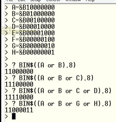

Thanks - will experiment with your demo code.
These are the results I got:
I will play around more with your demo code.
Still lost, but I will persevere.
It would seem that what I need is the ? BIN$((A OR B),8) command?
So therefore, A OR B should give me the combined result, yes?
What if we throw variable C into the mix?
Can you have something like ? A OR B OR C?
I will experiment some more.

  WhiteWizzard said  According to the table, shouldn't that be &B10011001
Yes, it should - typo - sorry.

Ahhhh - I think I am making slow progress.
Some experiments:
If I OR anything together, this would seem to put the bits where I need them.
I don't know if this is just because of the way I have setup my example or not though.

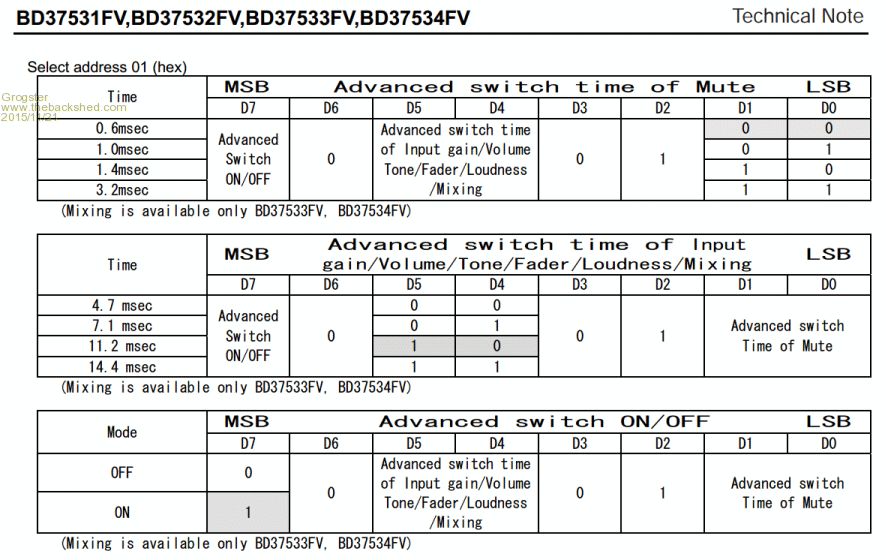

Here is a section of the ROHM processor manual:

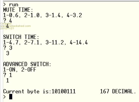

My experimental code:

Print "MUTE TIME:"
Print "1-0.6, 2-1.0, 3-1.4, 4-3.2"
Input A
If A<1 Or A>4 Then GoTo Start
Print A
Select Case A
Case 1
MT=APU_ASM0.6
Case 2
MT=APU_ASM1.0
Case 3
MT=APU_ASM1.4
Case 4
MT=APU_ASM3.2
End Select
Print
Print "SWITCH TIME:"
Print "1-4.7, 2-7.1, 3-11.2, 4-14.4"
Input B
If B<1 Or B>4 Then GoTo Start
Print B
Select Case B
Case 1
ST=APU_ASI4.7
Case 2
ST=APU_ASI7.1
Case 3
ST=APU_ASI11.2
Case 4
ST=APU_ASI14.4
End Select
Print
Print "ADVANCED SWITCH:"
Print "1-ON, 2-OFF"
Input C
If C<1 Or C>2 Then GoTo Start
Print C
Select Case C
Case 1
ASS=APU_AS1
Case 2
ASS=APU_AS0
End Select
Print
Print "Current byte is:";
BITE=(MT Or ST Or ASS)+4
Print Bin$(BITE,8), Str$(BITE)+" DECIMAL."
End
Done this way, with lots of constants, I can just easily or them together as discussed, and this seems to be working fine for building the data byte. The line that builds BITE, has "+4" on the end, as the data byte always has bit2 set for this command, and that also seems to be giving the correct results.
As I am keeping all the values in constants, there is no need for a sub to compile the byte as it can be done easily in one line.
