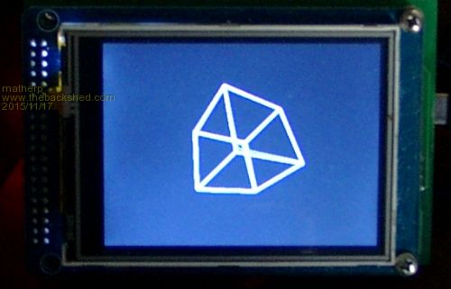

Please excuse the picture, my good camera isn't available.
This is a demo program (all in Basic) of some interesting maths that underpins all sorts of technologies like attitude/heading systems and 3D graphics.
Quaternions are a mathematical technique that allows the rotation in any direction of any shape. The maths behind it are way beyond me and extend the concept of complex numbers such that:
i*i == j*j == k*k == i*j*k == -1
I find that equation completely bemusing
However, quaternions are pretty easy to use in the real world. There are some gotchas: quaternions are not commutative e.g q1 * q2 does not give the same result as q2 * q1. But overall the calculations are pretty simple.
The attached code draws a wireframe cube and then rotates it continuously in the directions specified by the rotation quaternion.
The cube is specified as a set of coordinates around a point 0,0,0 in the array "cube". Then the array cubelines% is used to store the coordinate pairs that make up the lines that draw the cube.
The array "cubelocation" defines the actual position of the cube in space. The x and y axes are as per the display and the z axis comes out of the display towards the viewer.
The code uses a projection method of perspective to visualise the cube in 2 dimensions and "viewplane" defines the location of the projection plane in the z axis.
All quaternion arithmetic is carried out with the quaternion normalised. The subroutine "create_normalised_quaternion" takes a rotation vector and an angle and converts it into a quaternion.
Then to rotate a point we just multiply the rotation quaternion by the normalised coordinates of the point and then multiply the answer by the inverse of the quaternion. Note how in normal math this would leave the point unchanged but because of the non-commutative nature of the quaternion somehow the sequence does what we want (look at Jorge Rodriguez excellent videos on Youtube if you want to know more). Note that no trigonometry is needed other than in the initialisation of the rotation quaternion and that only uses the sine and cosine of a single angle.
The attached code includes all the routines necessary to rotate objects in 3D and then project them onto a 2D screen.
My interest is in using the math to understand what is happening inside a Attitude and heading reference system (AHRS), but the example code below is quite fun.
The code should run on any type of Micromite with a connected TFT display. The picture is of a 320x240 SSD1289 display driven by a 44-pin uM2.
Play with this line:
create_normalised_quaternion(2,1,0,0,q1())
to change the way the cube rotates. The parameters are:
number of degrees to rotate about the rotation vector
x-coordinate of the end of the rotation vector
y-coordinate of the end of the rotation vector
z-coordinate of the end of the rotation vector
array to receive the quaternion
Enjoy

That's really interesting Peter, I'd never heard of quaternion arithmetic. You can certainly see how it must speed things up by not having to constantly call trig functions though. I tried both your example and Michael's (his is 'groovier', sorry ), and his 'tumbling' one also seems to give the illusion of drawing a bit faster than your rotation on horiz axis one. That wouldn't be the actual case I suppose but it's interesting.
It's certainly a bit flickery on my 170/ili9341 setup but quite usable I'd say. No doubt a CFunction would trounce the flicker.

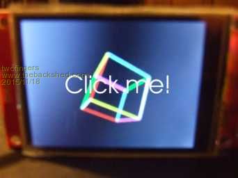

I used Peters code to make a MM Screensaver (assuming it's okay for Peter to post it here). This is a DEMO to show the versatility.
Michael
EDIT:
BTW. the framerate is ~8 FPS on a MX170/28 @48MHz.

I clicked on the image above ( the "click me" graphic ) ..I expected a
small video like a youtube clip. But it sent a zip file instead,
I would guess with the quaternion basic source ( don't know as
I deleted it ). Was that the intent ?
(I'm not after quaternion code, just thought it would be a nifty video)
