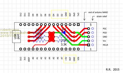

the article is a write-up of one and the same - covering schematic, construction of the hardware (veroboard layout), use of pic32prog and expected output, etc. with the release of new versions of mmbasic i'm hoping it may open up the micromite family to an expanded group of hobbyists who can now more cheaply/easily create a maximite or micromite from a blank PIC32MX device, or upgrade an existing 'mite to the latest firmware that geoff releases.
someone may also wish to create a cheap kit of parts: nano clone, small PCB, resistors, zener, wires, ICSP plug, etc. something that can be posted across the seas in a standard letter-sized envelope. below is a suitable (double-sided) layout for a 2" x 0.7" PCB that would sit below a nano.

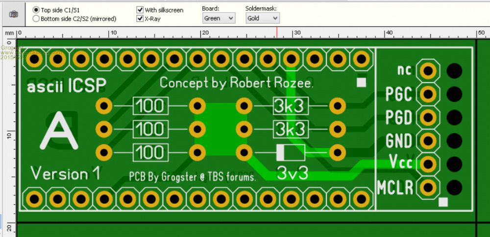

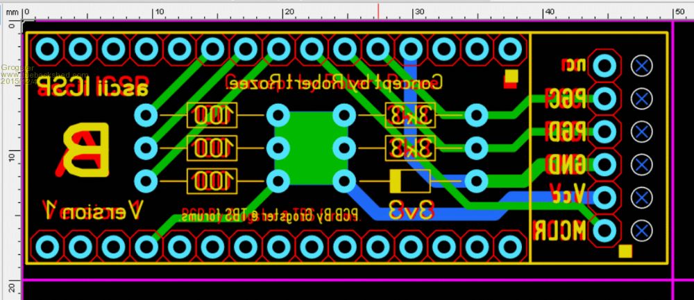

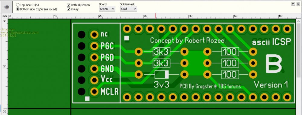

With Robert's permission, I post images here of PCB's I will be getting made for his programmer unit. I plan to offer kits for this at very low cost, in the best interests of getting people involved with the MM family of chips.
This PCB is final and has been approved by Robert, so no changes will be made, these images just to show you what it looks like.
Using Shenzshen-2-U PCB service, 100 of these little boards can be had for US$11.90, so 11.9c each. Bundled with a Arduino Nano from eBay and the extra resistors and zener, I expect the final kit price to be about US$7 + P&P, so about US$10 roughly, for full kit including Robert's PCB, the Nano board, all extra parts and airmail postage to anywhere on the planet. This is only about one third the cost of a standard PICkit3 clone.
