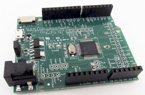

You can update the CGCOLORMAX with the update software that Geoff has on his site. The CGCOLORMAX you have can be updated to Maximite formware version 4.5.
The CGMICROBOARD ( you can buy one here ) is a Micromite (not a Maximite) and the BASIC in a Micromite is more advanced.
