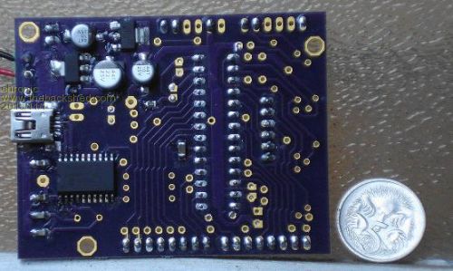

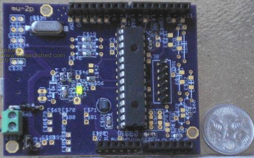

I have had prototype pcbs made by oshpark, who are excellent !! Beyootiful pcbs...
(ed)
The lurid photos.. I didn't bother about the silkscreen layer which has
come back to bite me, but as a prototype it's a bonza!! The coin is an
Aus 5 cents, about 2cm or 4/5 inch.

Posted: 11:26pm 31 Oct 2015
Nice looking boards there; nice to see them all built up!
I would have used ceramic caps instead of SMD electrolytics as I find the ceramics are cheaper, better spec, and smaller. The lower height off the ceramics may also make it easier to mount the PCB in an enclosure. NOT a criticism - just an observation
Do let us know how they perform for your application(s) . . . .

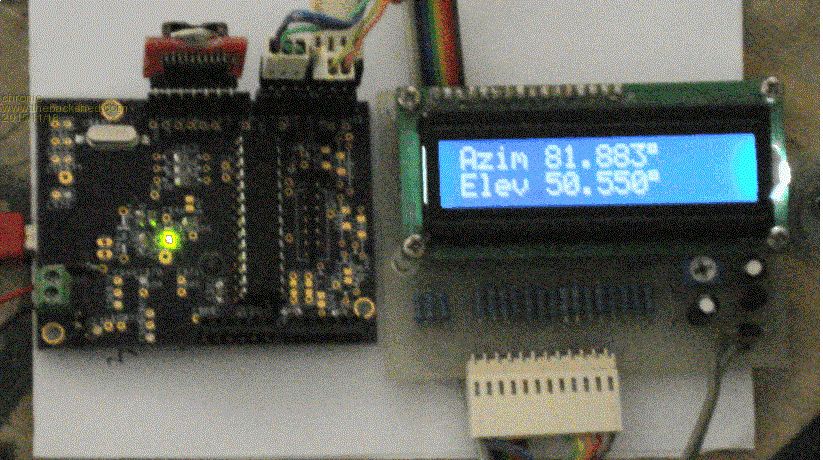

The board calculating solar position, using time from a ds3234 clock and preset
latitude / longitude, updating once a second.
Now to try to drive two mirror motors..should be straightforward. On
the other hand those 240x320 lcd's look so good...
(apologies for the photo quality, a bit fuzzy this morning!)
