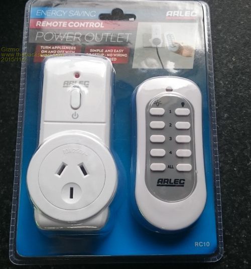

To drive the siren, I was going to include a mains rated relay and get the customer to use an electrician to wire up a siren via the relay contacts. But this can be a problem. I no longer have an electrical ticket, therefore I need to build the device using a plug pack supply and no 240 wiring of my own. Plus I wont be there to install the thing anyway, the workshop is 1000km away. So I went looking for a simpler option.
Bunnings ( also seen similar at Jaycar ) have a Arlec remote operated mains switch for under $15. http://www.bunnings.com.au/arlec-remote-control-power-outlet-_p4331239. Basically its a self contained mains switch that works via a remote control.
I'm thinking I could hack into the remote control unit, wire it up to the maximite, and this gives me a safe way to switch mains power. The customer can then just plug in a mains powered siren/bell/lamp/whatever into the Arlec switch.
No mains wiring is needed by me or the customer.
Comments?

I built something very similar, and this is a perfect way to get around your ticket issues.
You could still have the relay, but you would have to have another sparkie wire it in for you. This would be a requirement anyway, due to the distance, but I seem to recall that the Australian regs are quite ridiculous in a lot of ways, if Silicon Chip articles are to be believed.....
EDIT: An example is that more then once I have needed 240v to a panel, and I just install the panel, and say to the sparkie: "Can you give me some juice to that panel there please?" - done. They run some T&E and connect it for me.
I have a feeling that in Australia, it is NOT that simple.Edited by Grogster 2015-10-29

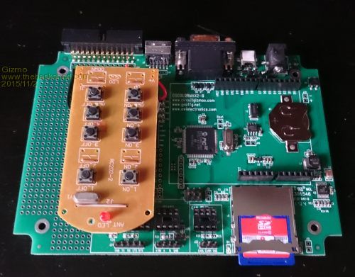

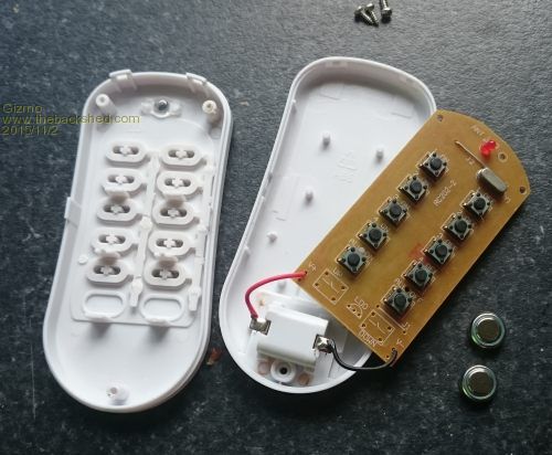

I bought a Arlec single outlet unit from Bunnings for about $13.
After testing it worked OK, I pulled the remote control unit apart to have a peek. It uses stantard pushbutton switches and runs on a 3.2 volts. When transmitting, the current is about 9mA.
Cool, this makes life easier.
9mA at 3 volts means I can power the transmitter directly off the Maximites 3.3v supply, eliminating the need for batteries. The transmitters push buttons are floating above 0v in a matrix of some sort, so I used a couple of opto couplers driven by the Maximite to switch the transmitter functions, the On and Off buttons.
The transmitter circuit board is mounted over the "sea of holes" on the CG Colour Maximite, with a few short copper wires to hold it in place. I removed a couple of the unused push button switches and used their copper pads as anchor points
Works a treat.
