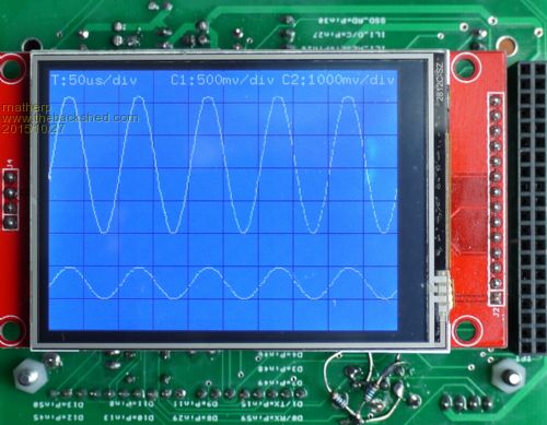

I've merged the two versions of the scope code into a single CFunction.
This single version now runs on any of the Micromites and supports both the ILI9341 and SSD1964 (800x480 versions only) displays. Shown here on a 64-pin MM+ with a ILI9341 display using my "ultimate" backpack PCB (note the PS2 wiring bodge - perhaps not so ultimate after all )
I've also made some slight performance tweaks and incorporated piclover's changes.
The automatic scaling of the display when low values of usec/division are used is now in increments of one rather than factors of 2 improving the amount of data available for display under certain circumstances.
Finally, I've increased the trigger timeout by 10 but now touching the screen will immediately return control to Basic to allow better integration with a GUI
The following Basic has been tested on 44 and 64-pin Micromites with both ILI9341 and SSD1963 displays but should also run on 28-pin and 100-pin parts with NO changes (note the use of the "npins" CFunction that tells you how many pins the chip you are using has so you can write simple conditional code):

Posted: 10:40pm 28 Oct 2015
Zonker has pointed out that the erase of the previous trace does not occur if you change the microseconds-per-division, offset or the scale. To do this the Cfunction would need to know the offset and scale of the last write as well as of the new write and I've run out of allowable parameters to the CFunction.
To get round this I've implemented a minor change as follows:
To remove a trace without writing a new one, call "scope" with exactly the same parameters as the last call but with the microsecondsperdivision negated. This will just remove the previous trace. You can then call scope again with the new parameters (including possibly a new positive microsecondsperdivision) and this will start the writing process again:

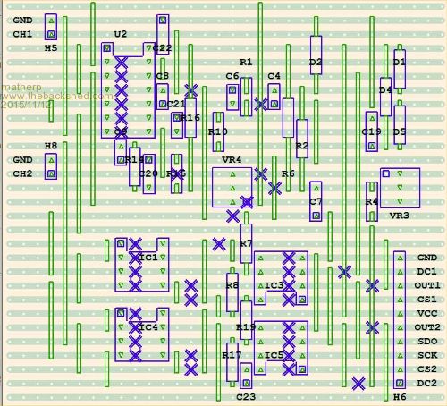

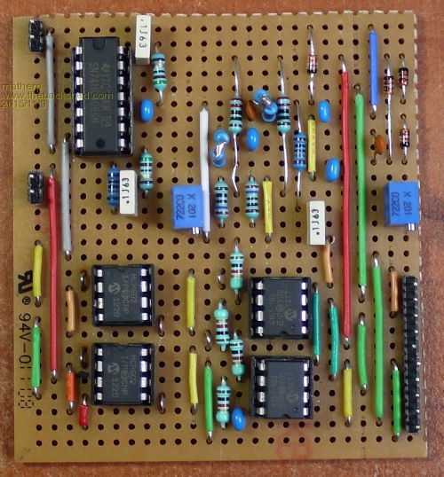

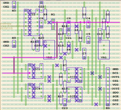

I've now built up a two channel programmable-gain, programmable-coupling, input stage.
The vero layout is:
The schematic is attached:
2015-11-09_133021_input.pdf
The labelling on the vero design should be obvious:
Inputs are on H5 and H8
H6 is the Micromite connection:
DC1 select the channel 1 input coupling: low to AC, high to DC couple
Out1 is the channel 1 voltage output for input to the Micromite DAC
CS1 is the chip select for the channel 1 programmable gain
Out2 is the channel 2 voltage output for input to the Micromite DAC
SDO connects to SPI 1 OUT
SCK connects to SPI 1 CLK
CS2 is the chip select for the channel 2 programmable gain
DC2 select the channel 2 input coupling: low to AC, high to DC couple
To set up the amplifier, set DC1 and DC2 high, short out H5 and H8 and apply power to the board. Then adjust VR1 and VR2 until Out1 and Out2 are exactly half of the supply voltage.
The digital pots control the gain of the second stage of the opamp
Gain is given by the equation "G = 1 + DigitalPotResistance/500"
I use 10K digital pots (MCP4161) which power up at 50% setting giving a gain of approximately 11 which is then divided by the x10 attenuator.

Hi Peter,
Can the software you used to create the vero layout for this produce a similar layout for Grogs expansion board for the E100?
Would be interested in building it on one & having a go at an interface.
Could be popular with novice users on a budget.
Even more so if the board could include your logic analyser.
I can probably work it out from the schematic; just not aware if the software can do the same as a very simple task for that type of layout.
Phil.
  matherp said   I've now built up a two channel programmable-gain, programmable-coupling, input stage.
The vero layout is:
