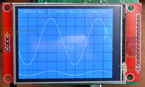

Here is a version of the oscilloscope code to run on a 28 or 44-pin Micromite with a ILI9341 SPI connected display. The display must be configured in landscape or reverse landscape mode.
The uM2 can't quite make the speed of the MM+, not because of the ADC, but because the code can't store the data fast enough without missing ADC inputs. In fact the MX170 ADC seems less noisy than the MX470 so the trace is cleaner.
All the usage is as per the original thread but I kept this one separate as there may be a bigger audience for the 28 and 44-pin chips
CPU 48

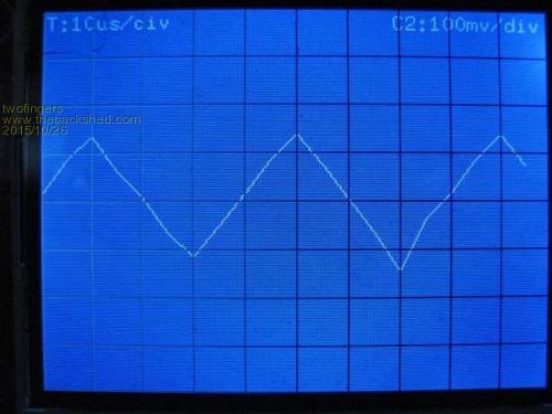

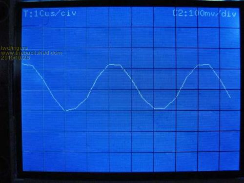

Hi Peter,
this is absolutely fun-tastic! (You made my day!)
I did not dare to ask you about a uM2 version.
For a first experience I used this slightly modified code.
CPU 48
Option explicit
Option default none
Dim integer i,j=0,toggle,channel1buff(320),channel2buff(320)
Dim integer microsecondsperdivision=10
Dim integer y1pos=-50, y2pos=0
Dim integer c1mvperdivision=1000, c2mvperdivision=100
Dim integer c1trig=0, c2trig=100
' 0.9Msps dual channel oscilloscope
' 28-pin
SetPin 2,ain ' Channel 1
SetPin 23,ain 'Channel 2
' 44-pin
'SetPin 19,ain 'Channel 1
'SetPin 10,ain 'Channel 2
Colour RGB(white),RGB(blue)
CLS
Font 2
i= scopeuM(microsecondsperdivision,toggle,channel1buff(),channel2buff(),y1pos
If i>1 And i<1024 And j=0 Then
Print "Warning reduced resolution x"+Str$(i)
j=1
If i>1024 Then
Print "No trigger"
Text 2,1,"T:"+Str$(microsecondsperdivision)+"us/div"
If y1pos>=0 Then Text 100,2,"C1:"+Str$(c1mvperdivision)+"mv/div"
If y2pos>=0 Then Text 220,2,"C2:"+Str$(c2mvperdivision)+"mv/div"
End
and your CFunction scopeuM of course.
With a 25KHz signal on PIN23 (only) I got this pictures, very nice!
But this is just a first step ...
May I ask you about the C source? Perhaps I'm able to learn something.
Thanks a lot!
Michael
