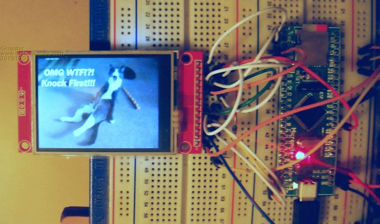

I have a folder of 'Funny Photos', so I just take one of them and resize so I can take a snapshot of it for the forums. Not my photos, not my cat. Funny photos keep the mood happy though.
Here is a link to the BMP of the above image if you want to try it out. BMP this time, not GIF....
