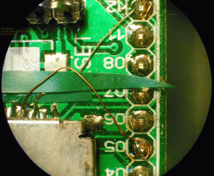

My latest unit however seemed to cause issues with FILES fspec$ but it has been confirmed that there is a bug. Initially I thought it was wire length but all is ok.
I have had up to about 12cm from EXPLORE64 edge pin to back of SD socket. So add on the track length too and that is easily 15cm from PIC to SD socket.
I have used both micro and standard size cards - no issues with either.
DO remember there are different pin-outs for the two different socket types
The only issues I have had are with the WP/CD pins on the SD socket. Sometimes the clearance between them and the metal body is so close that the pin gets 'earthed out' and allows a 'locked' card to be written to (or detected incorrectly). BUT this is when I hand solder a hair wire direct to the socket (so is human error) but with a man of your PCB skills this won't be an issue!
