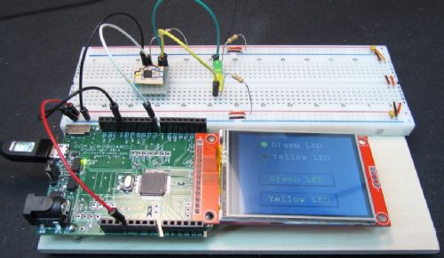

The Dallas/Maxim DS2413 is a nice little 1-wire device. It has two ports for input or open-drain output.
This lets you hang a DS2413 onto a 1-wire bus and have 1-2 switch inputs, or 1-2 outputs.
The open-drain outputs can sink 20mA and will tolerate 28V.
http://circuitgizmos.com/projects/mmbasic-projects/cgmicroboard-ds2413-1-wire-two-ports/
