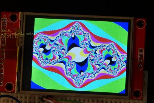

Julia set fractal on a 2.2" ILI9341 LCD:

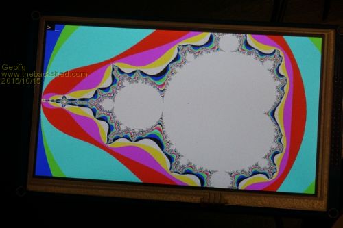

Mandelbrot set fractal on a 7" SSD1963 LCD:
The programs (modified to run on the Micromite or Micromite Plus) are listed below. Be warned, they can take a LONG time to finish:
'JULIA.BAS - Draws Julia set fractal images
'by loki
Dim As Integer MAXIT, COUNT
Cls
'Specify initial values
RealOffset = -1.30
ImaginOffset = -0.95
'Set the Julia set constant [eg C = -1.2 + 0.8i]
CRealVal = -0.78
CImagVal = -0.20
MAXIT=80 'max iterations
GAP = MM.VRes / MM.HRes
SIZE = 2.50
XDelta = SIZE / MM.HRes
YDelta = (SIZE * GAP) / MM.VRes
'Loop processing - visit every pixel
For X = 0 To (MM.HRes - 1)
CX = X * Xdelta + RealOffset
For Y = 0 To (MM.VRes - 1)
CY = Y * YDelta + ImaginOffset
Zr = CX
Zi = CY
COUNT = 0
'Begin Iteration loop
Do While (( COUNT <= MAXIT ) And (( Zr * Zr + Zi * Zi ) < 4 ))
new_Zr = Zr * Zr - Zi * Zi + CRealVal
new_Zi = 2 * Zr * Zi + CImagVal
Zr = new_Zr
Zi = new_Zi
COUNT = COUNT + 1
PIXEL X, Y, (COUNT and 4) * 4177920 + (COUNT and 2) * 32640 + (COUNT and 1) * 255)
Next Y
Next X
'MANDELBROT.BAS - Draws mandelbrot set fractal images
' by loki
RealOffset = -2.0
ImaginOffset = -0.85
MAXIT=70 'max iterations
GAP = MM.VRES / MM.HRES
SIZE = 2.8
XDelta = SIZE / MM.HRES
YDelta = (SIZE * GAP) / MM.VRES
CLS
'Loop processing - visit every pixel in screen area and base colour of pixel
' on the number of iterations required to escape boundary conditions
' If count hits max iterations then pixel hasn't escaped and is part of the set (the 'inner sea')
FOR X = 0 TO (MM.HRES - 1)
Cx = X * Xdelta + RealOffset
FOR Y = 0 TO (MM.VRES - 1)
Cy = Y * YDelta + ImaginOffset
Zr = 0.0
Zi = 0.0
COUNT = 0
'Begin Iteration loop, checking boundary conditions on each loop
DO WHILE (( COUNT <= MAXIT ) AND (( Zr * Zr + Zi * Zi ) <= 4 ))
new_Zr = Zr * Zr - Zi * Zi + Cx
new_Zi = 2 * Zr * Zi + Cy
Zr = new_Zr
Zi = new_Zi
COUNT = COUNT + 1
LOOP
NEXT Y
NEXT X

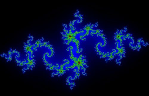

In the meantime I've been working on a Windows fractal program in C# that was until recently using the SetPixel() command to colour each pixel. I've been able to speed things up by writing the pre-prepared array of colour bytes directly to the bitmap memory location, then calling the Invalidate() method on the picture box control (that has the bitmap bound to it), which causes Windows to invalidate the entire surface of the control thus forcing it to be redrawn.
Don't know if this approach could be used on the mites or not. Is video memory directly accessible in any way, rather than use the PIXEL command? Is it possible to create a new api in mmbasic that would be analagous to microsoft's DirectX api?

  loki said  Don't know if this approach could be used on the mites or not. Is video memory directly accessible in any way, rather than use the PIXEL command?
In the Colour Maximite you can write direct to the video memory buffer and you can get the address of this buffer using PEEK.
In the Micromites each pixel is sent over a SPI or parallel bus to the display which buffers it there. But, when experimenting with your programs I found that the limitation was the speed of the interpreter, not the display. I bet that it would be the same even if you were writing in C
In the Micromite you can load C routines using the CSub/CFunction facility. It is not an easy environment (eg, it is difficult using floats) but it would be fast.

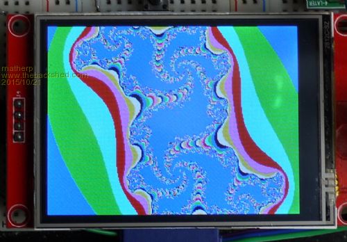

This was drawn much much faster - 10 seconds
I've converted the JULIA code to a CSUB as an exercise.
This allows you to set the four parameters CRealVal, CImagVal, RealOffset, ImaginOffset in the call to the CSUB. Note that because of a limitation in CFunctions and CSUBs you have to call JULIA with variables rather than literals.
In the code I've included all the example parameters from loki's original post and the program steps through each one in turn taking about 10 seconds each on a ILI9341 driven by a MM+.
The code should work on any Micromite with any of the supported display types
