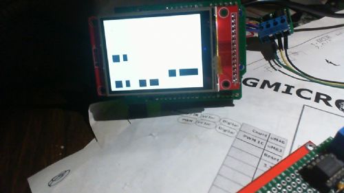

While trying to update or change the values of hidden controls, they are still trying to set the background of the control to the color defined during the controls creation... (me thinks)...
I used a white background to catch it... Normally, I would be using black as the background, so it would be easy to miss... the same happens when setting the "ghost text"...
Will keep playing...
