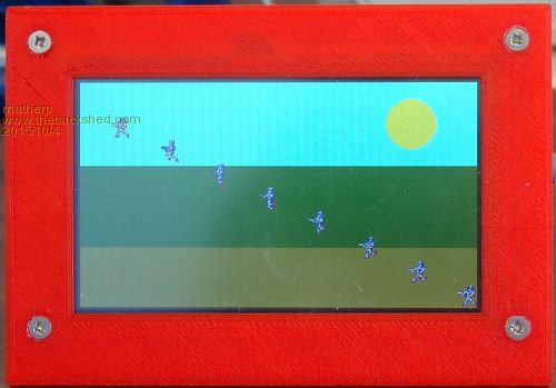

See the video

I've then written a CFunction that allows one or more sprites to be displayed on a SSD1963 screen. Of course a "sprite" need not be a complex graphic but could equally be a text character. The code would then allow text to be superimposed on a pre-defined background rather than overwriting it.
There is one callable CFunction SPRITE. This takes the following parameters:
Mode: can be clearsprite=0, writesprite=1, movesprite=2
RDpin: The number of the pin connected to the RD input of the display, needed to read the display memory
X%: x-coordinate of the top left of the sprite to be written or displayed
Y%: y-coordinate of the top left of the sprite to be written or displayed
width%: width of the sprite in pixels
height%: height of the sprite in pixels
displaybuff: an array used to hold the contents of the display memory before displaying the sprite
OPTIONAL spritebuff: an array holding the pixel information for the sprite, not needed for the clear mode
OPTIONAL NewX: x-coordinate of the top left of the new position of a sprite to be moved, in this case X% holds the original position
OPTIONAL NewY: y-coordinate of the top left of the new position of a sprite to be moved, in this case X% holds the original position
The way the sprite write-mode processing works is to:
Save the existing display contents in the area defined by x,y,width,height
Write out the sprite but overwrite only those pixels which are non-zero in the Sprite
Move mode works by:
Restoring the display content in the area where the sprite was originally located
Saving the display contents in the area where the sprite will now be located
Move mode is the same as doing a "clear" followed by a "write", but because it is done as a single CFunction call it is much quicker. Note in the video there is a 40msec wait between each "step" so the update capability is much faster than shown.

  matherp said   I have also shamelessly stolen his example sprites to use on the Micromite in my test program.
And i have 'shamelessly' stole them from Turrican game
I given the full Lemmings pack to Uwe too , i don't know what is on the zip in his page.
For Lemmings , the original are so small that i go for made a 'Double Size' button
on the Sprite Editor.
Most of 'old' games with sprite are not often bigger than 16x16 pixels , then this option will be good to do ...
Here on stmF7Mite (480 x 272) the Turrican are just the right size , but not Lemmings (i need my google)

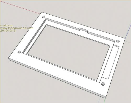

Peter, can I ask how or where you obtained the enclosure for the screen?
GM
Posts: 12076
Posted: 08:49pm 05 Oct 2015
  Quote  can I ask how or where you obtained the enclosure for the screen?
It is 3D printed. I'm away from home at the moment but can post the .STL file when I get home
Posts: 12076
Posted: 03:33am 13 Oct 2015
3D model attached as promised. Note the cutouts for the header pins and the touch screen cable
and model file:
2015-10-13_133222_mountforscreen.zip

Joined: 11/04/2012
Posts: 1056
Posted: 11:21am 13 Oct 2015
  matherp said   3D model attached as promised. Note the cutouts for the header pins and the touch screen cable
Peter, thank you for that info.
