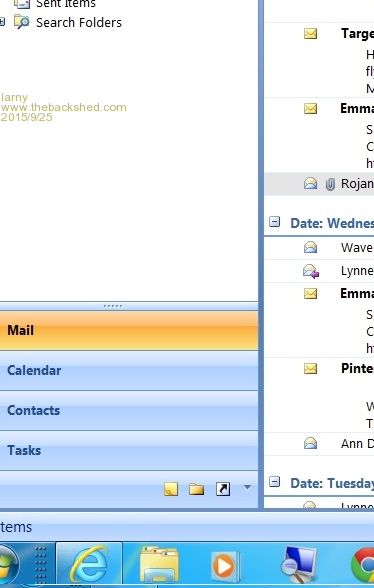

As you can see in the image below (I copied the left hand lower portion of the screen - the sample is about half the screen in height) the left hand edge of the screen is missing.
Also note that the text is small.
I experimented with the buttons on the Monitor and found that I could change the Horizontal position, but not the scanning width.
I attempted to change the text size in Windows 7/Control Panel/Display & in Microsoft Outlook without success.
Does anyone know how to fix these issues?
Does any one have a User Manual for the Benq mentioned above or one for a similar Monitor?
Any assistance will be appreciated.

i believe there is an "auto" button, the leftmost in the row. press and hold this auto button for several seconds. your problem will be fixed.
for others wondering: this appears to be an analog interface only monitor.

  robert.rozee said   i believe there is an "auto" button, the leftmost in the row. press and hold this auto button for several seconds. your problem will be fixed.
rob :-)
Thanks Robert, that did the trick.
However, this monitor has a VGA & a HDMI input.
Thanks to everyone who replied. Much appreciated.
