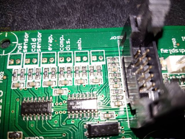

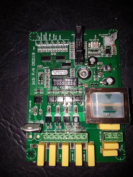

I'm in the process of building a replacement controller board for a heat pump unit I'm converting to a Hot Tub heater.
Original board is fried, but would also not work outside it's native environment, of the tank & associated sensors.
It accepted 5 thermistors from the heat exchange unit & another 4 from the water tank.
I just plan to use the 5 on the HP, primarily for protection of the unit.

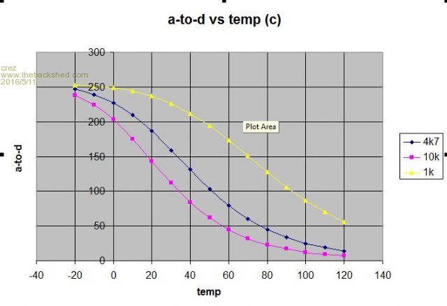

Choose the same resistance as that of the thermistor at the middle of the range of the temperatures you are trying to measure. This maximises the worst-case temperature resolution. I have attached a graph from an excel spreadsheet that I made to help visualise the situation.
e.g. if you want to measure from 20c to 40c, calculate your thermistor resistance at (20+40)/2 ie 30c. Use approximately this resistance to analog Vdd to bias the thermistor.

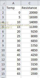

Values I measured & the quoted values were:-
So I'm probably better off going with 8k or lower even, as opposed to the 10k the original control board used.
Or I could mix values & deal with in in software, but could be a bit of a pain.
