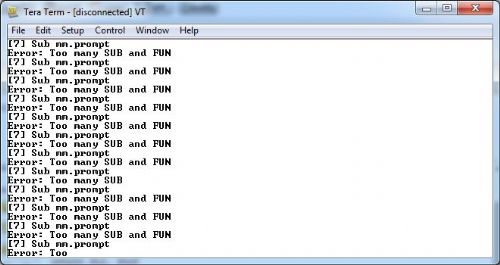

This is a weird one:
I did an XModem transfer of this code:
[code]
Const ds4 = 4
Const ds3 = 5
Const ds2 = 6
Const ds1 = 7
Const sw1 = 16
Const rp1 = 26
sub mm.prompt
setpin ds4, dout
setpin ds3, dout
setpin ds2, dout
setpin ds1, dout
setpin sw1, din
setpin rp1, ain
Print "LPCDB>"
end sub
[/code]
and the Micromite (28pin) went into an unbreakable loop with the following Console Output:
Chris

Posts: 6631
Posted: 12:05pm 20 Sep 2015
Chris
I think the important part is the error message I got at the beginning of the output:
sub mm.prompt
setpin 4, dout
setpin 5, dout
setpin 6, dout
setpin 7, dout
setpin 16, din
setpin 26, ain
Print "LPCDB>"
end sub
Saved 313 bytes
[11] SetPin 4, dout
Error: Pin 4 is reserved on startup
[11] SetPin 4, dout
[11] SetPin 4, dout
I am using pin 4 for the LCD so the error message is valid, just no way of fixing it.
Eventually the message changed to too many SUBs the same as Chris.
I was unable to reset the MM+ and had to bring out the programmer....
I think that if there is an error in MM.PROMPT, we should be put back to the normal prompt without trying to run the sub again.

Posts: 3369
Posted: 03:36pm 20 Sep 2015
Yes, now that I am concentrating on the MX470 (Micromite Plus) I plan to do the 100-pin version as well as some important bugs (eg, USB and Win 10).
This beta has a couple of issues with MM.PROMPT - First, it is not consistently recognised after EDIT, XMODEM, etc. The second is that an error inside the sub causes mayhem. I will fix both of these in the next release.

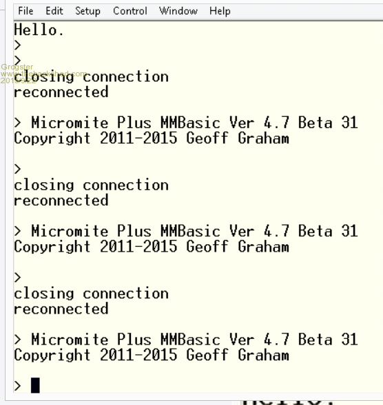

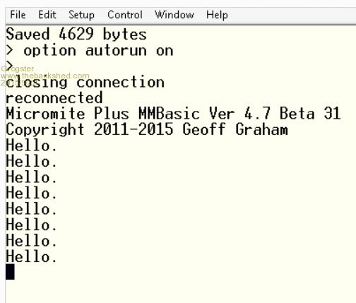

EDIT: Seems OK on my module - I just setup a "Hello" loop, and then reset the MM+, and away it went as it was supposed to:
