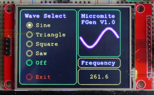

In this "full" version I have added a GUI using the touch screen on the ILI9341 display running on a MM+. It allows a range of waveforms to be created between 1 and 50,000Hz. The user interface would need reworking on a uM2 to replace the GUI commands but the cFunction will work as is.

The GUI allows selection between sine, triangle, square, and saw tooth waves. I have also modified the CFunction to accept the frequency as a floating point number. This allows the exact frequencies such as middle-C (261.6 Hz) to be input.

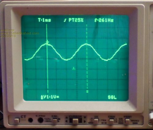

Of course a 4-bit DAC gives a fairly rough waveform but with judicious use of an RC-filter it can be smoothed to give a quite good output.
10Kohm/1nF works nicely at 1000Hz
10Kohm/220pf works at 5000HZ
In the picture I've used 10K/4.7nF with a 261.6 HZ Middle-C output

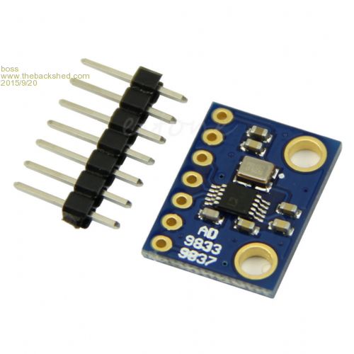

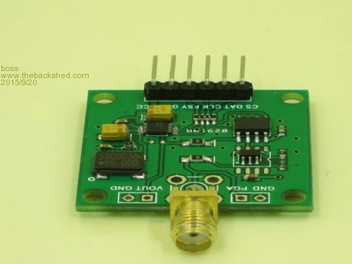

And if you add one of these AD9833 modules you get the signal generator covers band from less then 1Hz to 12.5 MHz (with simple low pass filter or ~6MHz w/o filter.
The module price is ~$6 for basic not -amplified module while amplified version is around $10. Together with graphic display you have a nice equipment for less than $30.
