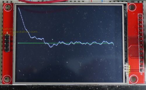

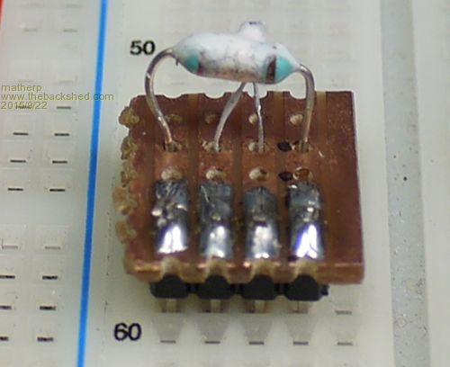

First job was to create a testing environment
So I bonded a 100K thermistor to a 20ohm resistor using some thermal glue. One end of the resistor was connected to +5V, the other to the collector of a 2N2222 transistor. The emitter of the transistor was connected to ground and the base to a MM output pin via a 180 ohm resistor. This gave me a simple "heater"
One end of the thermistor was connected to ground and the other to 3.3V via a 4K7 ohm resistor making a potential divider. The mid point of the divider was connected to a MM input pin via a simple RC filter.
This gave me the measuring input for the controller.
The test system has very little thermal mass and the temperature changes very rapidly with just a slight air movement so should provide a good challenge for the controller.
The Basic program uses the thermistor code I have published in a separate thread and is fairly straightforward.

if display then
CLS
line 0,120,319,120,,rgb(green)
endif

if fval!>-120 and display then
pixel k%\2,fval!+120,rgb(white)
k%=k%+1
endif

The code takes a target temperature "setpointtemp=70" and converts it to an ADC reading (0-1023) that the code expects to see if the target is met.
The PID coefficients are then set up "Kp=-2.5,Kd=-10,Ki=-0.5". These have been very roughly tuned. For PID tuning in general consult google.
Then the loop duration for the control is set up "dt = 300" in msec. Finally, as the output isn't centred on zero we set the bias position for the output to be 60% "bias=dt*0.6"
The way the control works is that the PID loop turns on the heater for a part of the PID loop based on the calculations in order to try and achieve and maintain the setpoint.
