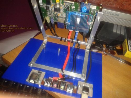

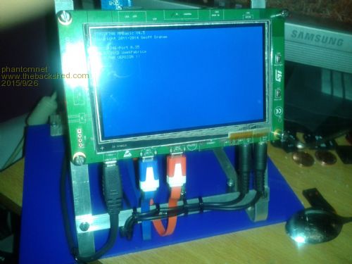

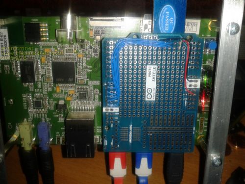

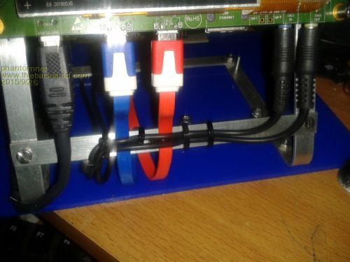

This is my test setup:
STM32F746 Discovery
Arduino proto shield
CC1101 board
Rear view
Front view
Connectors
Prototype Shield
Work in progress:
CC1101 432Mhz scanner (thanks for SPI1/SPI2 implementation )
