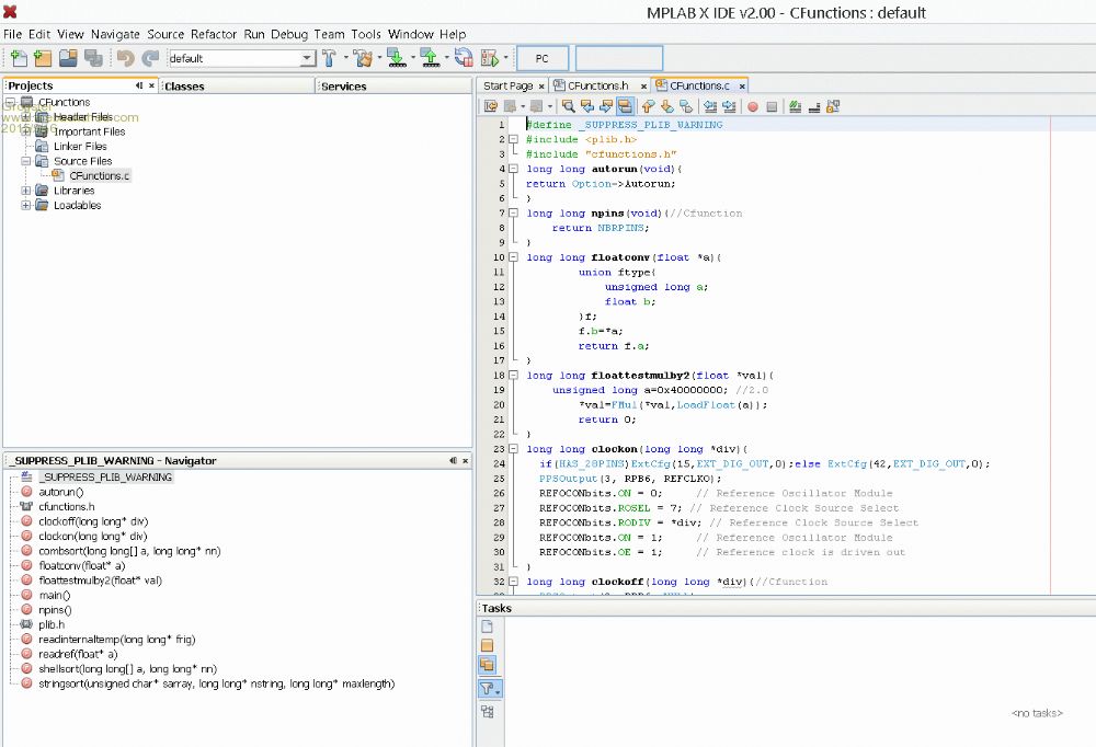

Run MPLabX. From the file menu select "Open Project". Browse to the directory containing the extracted sample "CFunction.X" and click "Open Project"
This should open various windows, on the left hand side is the project browser, the main panel is the source code for the sample.
Click on the hammer icon with the brush and the output window will display build progress and hopefully a message saying "Build Successful"

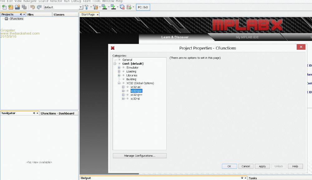

Posted: 04:33am 16 Sep 2015
I get no such options under xc32-gcc:
Posts: 12074
Posted: 04:40am 16 Sep 2015

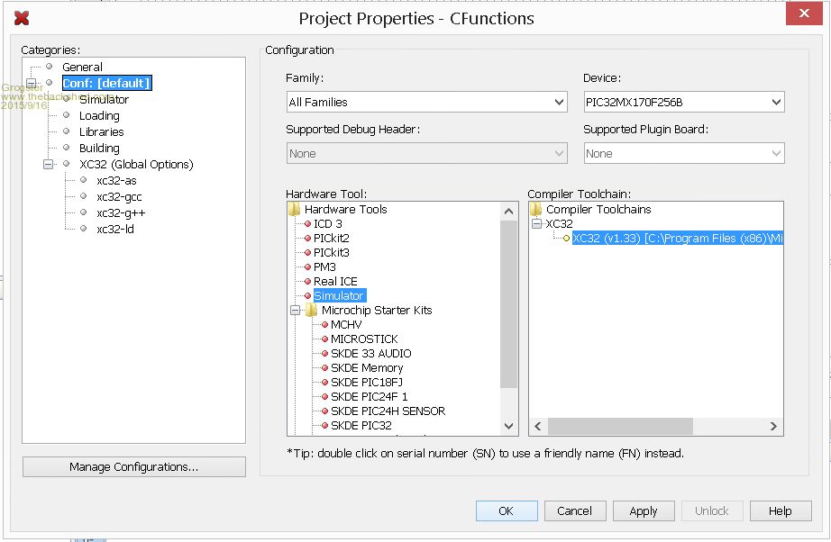

What do you get when you click on "Conf:[default]"?
Posted: 04:46am 16 Sep 2015
This is what I get:
Posts: 12074
Posted: 04:51am 16 Sep 2015
That looks OK. Does the project compile (hammer with brush)? Which version of MPLabX are you running? if less than 2.26 then upgrade.

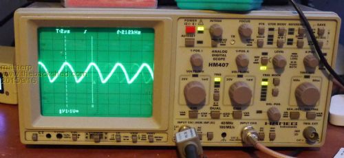

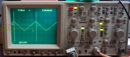

From the PIC32 manual we can see that the reference voltage will be output on pin 25 of a 28-pin MX170 and pin 14 of a 44-pin part. Page 23 of the MX470 manual says the reference will be on pin 23 of a MM+ (untested)
My test program looks like this:
dim i%=triangleout(1000000)
end
CFunction triangleout
00000000
8C8A0000 8C8B0004 014B1025 50400021 00001021 3C06BF81 24050020 2407001F
24090010 3C0FBF81 340E8000 254CFFFF 018A502B 256BFFFF 014B6821 01805021
01A05821 1000000B 00004021 00E21823 0044180B 34638060 ACC39800 24420001
1445FFFA 2C440010 25080001 11090004 00000000 00001021 1000FFF6 00001821
ADEE9804 018D6025 1580FFE9 254CFFFF 00001021 03E00008 00001821
End CFunction
On my Scope I get a rough triangle waveform of 2V amplitude and frequency of 212KHz
Next post I will look at setting a specific frequency for the output

My version is:
dim i%=triangleout(10) ' run for 10 seconds
print i% ' CPU speed
end
00000000
3C029D00 8C420000 8C420000 00021042 8C830000 70431002 00001821 40834800
0062182B 50600013 34038000 3C07BF81 24060020 2408001F 40094800 00001821
10000003 00002021 01032023 0065200B 34848060 ACE49800 24630001 1466FFFA
2C650010 0122182B 1460FFF3 00000000 34038000 3C02BF81 AC439804 3C029D00
8C420000 8C420000 03E00008 00001821
End CFunction
