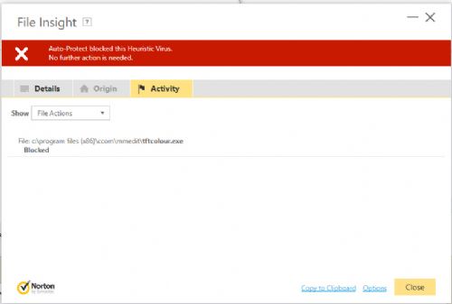

GDay Jim,
I Just installed V3.6.4 and Norton keeps flagging (and blocking) TFTCOLOUR.EXE as `suspicious cloud' Virus.
Have you any thoughts along this matter?
See attached screen cap.

Posted: 06:26pm 17 Sep 2015
Norton's Suspicious Cloud sounds a bit like their 'Reputation' Virus
Norton's hasn't seen the file before so it assumes the worst.
You should be able to tell Norton's to leave the MMEdit folder alone.
I could digitally sign my files but if I did it the cheap self-signing method, it would make no difference.
If I was filthy rich, I could sign them with a paid for signing company and then Norton's would be happier.
It is no coincidence that Norton's own the signing company.
You could submit the file to Norton's and they might put it in their known about file but you would have to repeat the exercise every time I update the program.
I can add version information to the executable which sometimes helps but only sometimes. I will do that in a few days when I get back home.

Hi Jim,
I am sure that it was a `false positive' but thought I would mention it. I have excluded the file from scans and restored it. So all is running well.
Norton labelled it as a heuristic virus for what its worth.
