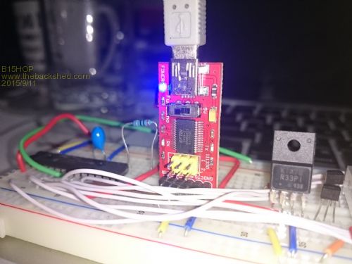

I have a micromite 28 pin from here:
http://geoffg.net/micromite.html
The thing worked perfectly for first few trials. Using a serial connection to talk to it at 38400 baud and I was able to write some code etc...
All of a sudden, the micromite decided not to communicate back to the rs232 chip. So even though the LED's light up, the chip seems not to be responding. Ironically the software that I had written in MMBasic still runs every time I fire up the chip. So basically the chip works but I can no longer talk to it. Is there a way to factory reset the chip or get it back to how it was before?
Just so you know, I tested the rx/tx serial by looping back on itself. It works, so it's not the rx/tx serial board (sparkfun board).
EDIT: Oh and I tried using the rx/tx short method to factory reset the pic32 and that didn't work either.Edited by B15HOP 2015-09-12

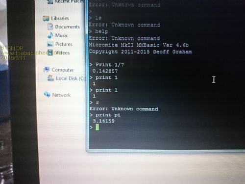

Hi TZ Advantage and thank you. :)
Chip was preprogrammed with Micromite firmware mk2 4.6 (see pic from when it was working)
Don't have PicKit3
Never got to set a pincode
Cap is a tantalum brand new and good.
I unwired all the white wires you see in the first pic and then re connected Tx / Rx to make sure it wasn't those wires. I triple checked pin positions and still no luck.
I'm suspecting the USB cable because when the machine boots, you can see the sparkfun try to send data but nothing comes my way. So possibly it could be the cable. Will try another cable soon. But then that wouldn't make sense because if i do a loop back on tx / rx I wouldn't see a reply huh?
Edit: Cheers for all your help. Still baffled. Still won't reset for me either.Edited by B15HOP 2015-09-12

Hey Jim
Sparkfun is set to 3v3, it has a switch to set either 3v3 or 5v as you can see in the pic it's on 3v3.
Connecting via breadboard but now i'm tempted to soldier to see if that fixes the issue.
Tried shorting rx/tx but that doesn't do anything.
