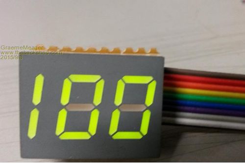

Found one.......
After an extensive search of the workshop I located the said items
And guess what? The electric jug does boil at 100 degrees Celsius according to the DS18B20.

One question if I may... How do you drive the 3rd digit to get the 1 in 100? You dont seem to support that in your code (at least that my feeble eyes can see)
PS. Remember I still owe you some money/boards so don't let me skip town on you.

@ TZ I know that I am a couple of hundred meters above sea level so being the scientist I am, I compensated and put the kettle on the floor
@ Mick, I will post the amended code when I am back in the workshop.

HERE IS THE LOOP MODIFIED FOR THE THIRD DIGIT. THE ONLY PREREQUISITE IS SETPIN(23),DOUT TO DRIVE THE 100'S DIGIT.
TRTEMP=DS18B20(2)
TEMP$=Str$(TRTEMP,2,0)
Print TRTEMP
H=Val(Right$(TEMP$,1))
For J= 1 To 7
If NUM(H,J)=1 Then Pin(D1(J))=0 Else Pin(D1(J))=1
Next J
If Val(TEMP$) < 100 Then
Pin(23)=1
K=Val(Left$(TEMP$,1))
For J= 1 To 7
If NUM(K,J)=1 Then Pin(D2(J))=0 Else Pin(D2(J))=1
Next J
Else
Pin(23)=0
K=Val(Mid$(TEMP$,2,1))
For J= 1 To 7
Next J
Pause 1000
