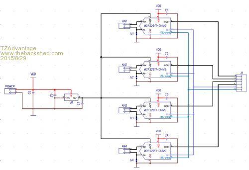

I have designed a little board for capturing 4 analog values.
It can be used with the 3001/3201/3301 A/D converters from Microchip.
Also has a voltage regulator for a precision VREF.
That can be the MCP1541 for 4.096v or a MCP1525 for 2.5v.
I tried to place the parts as good as possible to minimize noise.

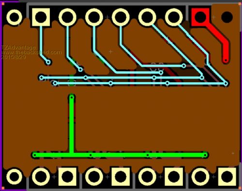

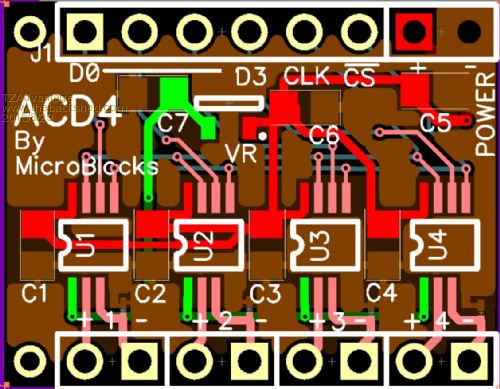

Some feedback about the ground planes would be welcome as that is my weak point with analog/digital mixed circuits.
The reason for 4 chips and not a single 4 channel chip is that all 4 analog converters can be sampled at exactly the same time.
Schematic:
PCB is 23x18mm.
Top layer:
Bottom layer:

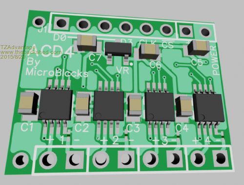

3D:

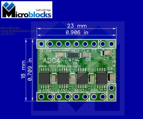

I have tweaked the design a bit. Made the groundplanes better, added a separate VREF connection.
This is the 3rd Microblock that is ready to be manufactured.
I still have a few more to go. :)
