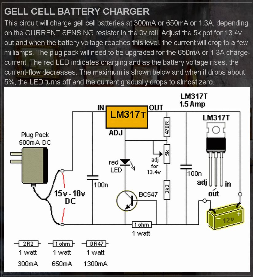

I am thinking that something along the lines of this circuit would be a good starting point - simple, and probably very effective.

EDIT: There is also this circuit by Colin Mitchell:
I like this one too.
I only need a slow(or trickle) charger - fast charging is NOT required, but some form of current-limited charger would be the way to do it, which is why I like these 317 setups, and 500mA or so would be be perfect.
Has anyone here used the likes of the circuits above, to charge their own Gel-Cell batteries?Edited by Grogster 2015-08-22
