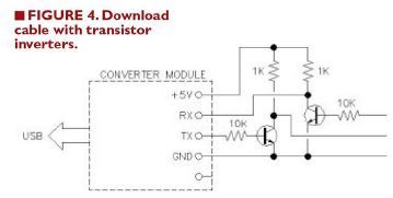

There was a recent article in Nuts & Volts about inverting signals for PICAXE.
I can't recall the issue off hand but will try and find it for you.
He just used a couple of jelly bean transistors.
Chris
http://caroper.blogspot.com/
Chris Roper
Joined: 19/05/2015
Location: South Africa
Posts: 280
Posted: 11:20pm 19 Aug 2015
OK - Found it. It was July 2014, how time flies I thought it was more recent than that here is the circuit, you need. There was not much supporting text but the circuit is self explanatory:

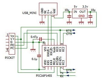

For the sake of keeping everything in one place here is the schematic to aid in setting it all up.

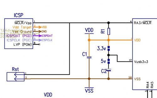

Posted: 01:22am 26 Aug 2015
Chris,
How did you wire up the 1455 and be able to choose between5v and 3v3?
I know that supplying a voltage to VDD can be just a jumper.
Did you also place a jumper to connect the Vusb3v3 to either a capacitor to ground or to VDD?
I place some solder bridges, but would rather go without if possible.
Chris Roper
Joined: 19/05/2015
Posts: 280
Posted: 02:14am 26 Aug 2015
  TZAdvantage said   Chris,
As above but no jumper on Vusb, I just tied it to ground via a Cap.
The F series parts have an internal regulator, the LF parts tie it internally to Vdd so it should make no difference.
I tested mine at both 5V and 3V3 without problems, but I have no idea what the Long-term result may be :)
I even accidentally used an LF part and ran it at 5V for a couple of minuets and it worked, but I pulled power as soon as I noticed.
Chris
Edited by Chris Roper 2015-08-27
Just a back-up post to confirm what Chris already told you...
As Chris said this is quite wrong. Do not ever put 5V on Vusb3V3. This is the USB voltage and it needs to be 3V3 always. Again Chris was right about the difference between the "L" parts and the "LF" parts. For "L" parts Vusb3V3 goes to a cap (has internal regulator) and for "LF" parts you supply 3V3 on this pin.
USB is never switched btween 5V and 3V3, it is always @ 3V3, even in what otherwise may be a 2V system!
It is the CPU, other peripherals and I/O that get switched between 3V3 and 5V via VDD.
Posted: 08:10am 26 Aug 2015
In this case it is solely for the F part that has the internal voltage regulator.
If the 5v solder bridge is closed and i provide 3.3v to vdd would that then still works.
Basically what happens is that the internal voltage regulator gets 3.3v on its input.
I wonder if the USB circuitry in the PIC will still work correctly in that case.
In the current schematic it is either the 5v bridge or the 3.3v bridge that is closed.
I would like to remove those bridges and connect Vusb3v3 with a cap to gnd directly.
If 3.3v or 5v is supplied to the Vdd you then choose the output levels to prevent the use of level shifters. I specifically choose the F part for that.
Having no solder bridges would make use of the module easier as someone could close both bridges and damage the PIC.
Edited by TZAdvantage 2015-08-27

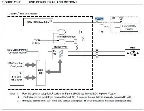

Posted: 08:26am 26 Aug 2015
Just tie it to ground Via a Cap.
You can't feed 3v3 in on a 5V (F) part or you would be tying the internal regulator output to an external 3v3 supply.
There is a drawing in the DataSheet with a note to say that connecting Vusb to 3V3 may work on an LF part but should NOT be done on an F part.
I will try and find it.

Posts: 12074
Posted: 09:27am 26 Aug 2015
On an F part if you connect Vusb to 3V3 then the chip gets very hot and stops working Edited by matherp 2015-08-27
