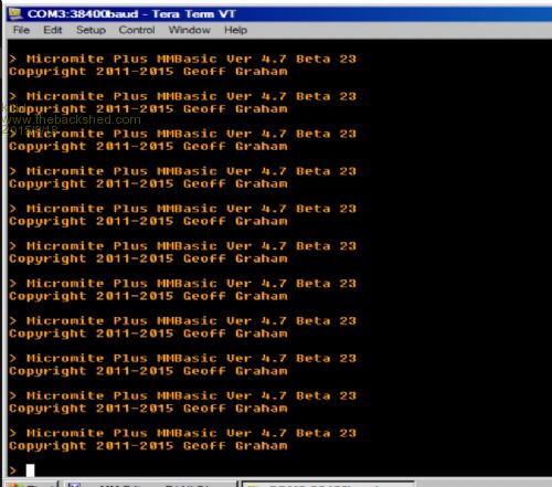

There is also another, probably unrelated bug in the USB console. See the picture below. The start up message gets printed at random times, even if I am in the editor at the moment. The picture shows the terminal after about a minute without any activity from my side. This bug also doesn't seem to exist in the MX170 port.

I have never seen that on the USB console, but I can simulate it with a lose main power connection - check there is nothing wrong with the power connections, or that there is nothing perhaps shorting MCLR to ground. This is exactly the message that comes up every time you pull MCLR low, or cycle power, which makes me wonder if you have a dicky power connection somewhere?

Yes, of course that's what I would have assumed too. But even with a 1k pull up resistor on the MCLR pin, the result is still the same. If I am the only one who is seeing this, probably it is another W10 effect.

The USB issue could be due to the control signals sent by the USB host. MMBasic uses a query from the host as the trigger to display the banner - this is how it knows that someone has started a terminal emulator on the host. Perhaps Win10 does these things differently. Another thing to investigate when I get back.
