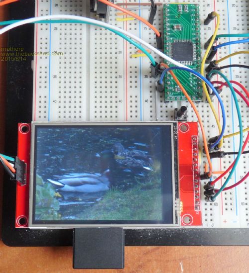

Code to follow once I've generalised and tidied it up.
Ducks on my pond, 320x240 image displayed in 2.3 seconds
Thanks of course to Peter Carnegie (G8JCF) for his brilliant SD card routines for the MX170 Micromite. Shown on the 44-pin version but will work just as well on the 28-pin chip.
Edited by matherp 2015-08-15
OA47
Joined: 11/04/2012
Posts: 1050
Posted: 12:44am 14 Aug 2015
It just gets better..........................
Great work guys
GM
Posts: 11800
Posted: 01:34am 14 Aug 2015
OK: Here is the code:
To use the code you need to transform your pictures into an RGB565 file. This is a two-step process, first convert your pictures into an appropriately sized .BMP file. Then convert this to the actual RGB565 file that will be used in the program. This is done using a simple program created by ChaN, the same genius responsible for the SD card routines that PeterC has used and the author of the full FatFS routines that have become the de-facto standard throughout the embedded development space.
2015-08-14_111537_bmp2bin.zip
This file contains the bmp2bin conversion program (also available on ChaN's website ) and the two picture files used in my code below:
The bmp2bin program is run in a DOS box (Accessories/Command Prompt) so I find it convenient to keep it on the root directory of the SD card. Then once you have copied your .BMP files to the SD card you can open a DOS box and set the directory to the SD card (e.g. F:<cr>) and run the program "bmp2bin myfile.bmp"; no options are required.
This will create the file myfile.bin on the SD card ready to be plugged into the Micromite and used by the program. The SD card slot on my ILI9341 display works perfectly with PeterC's SD card code.
The bin file format created by bmp2bin is a 4 byte header giving the width and height of the picture, followed by the picture data in binary RGB565 format. Working this way means the code in the MM is kept to an absolute minimum and the picture will draw at the fastest possible speed.
The code, of course, assumes the display has been initialised before use using the normal OPTION LCDPANEL command. All normal MM drawing routines will continue to work before and after a picture is displayed.
The drawing subroutine is simplicity itself to use:
DisplayPicture("bss.bin",100,70)
says display the picture "bss.bin" with the top-left corner at coordinates 100,70.
the coordinates are optional and 0,0 used if not specified.
The SD card routines are unchanged from PeterC's version 1.7
If you are only using the SD card for displaying pictures you can delete most of the Basic wrappers for the SD card handling routines. Check the DisplayPicture subroutine code for which ones need keeping.
Enjoy

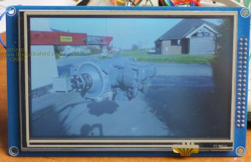

Eureka - struggled a bit but finally got it Peter. Mind you, it must have been a typical English day when you took the duck photo - it's pretty dark on my 2.4" ili9341 screen, but it's definitely there.
I had to use a barebones 170 because Mik's SMD backpack (that I've been using) has Pin 6 (the SPI2 MISO) hardwired to the panel's Pin 3 (CS). I've now got the SD card CS on Pin 23 and changed the panel's OPTION setup command to use CS on Pin 15. Pins 23 & 15 don't seem to have too much important on them - says he, ducking!
Now, just gotta find some nice bright photos!
Greg

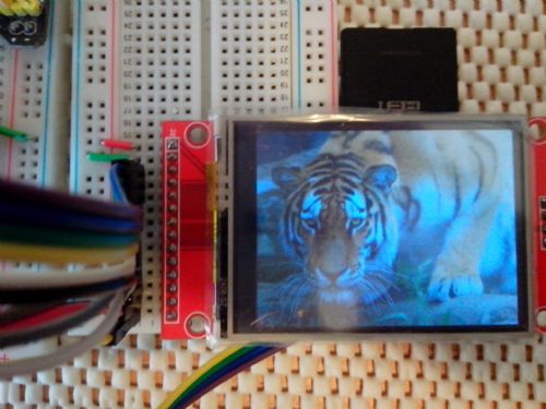

Joined: 07/10/2011
Posted: 08:26pm 17 Aug 2015
Here's a better one, uM2 SD card on the the ILI9431 screen. Little cousin to Geoff's big tiger on the 5" uM+ screen.

Posts: 11800
Posted: 01:25am 19 Aug 2015
One last version:
Sorry about the poor picture of a picture.
This uses the new 44-pin uM2 8-bit databus, 24-bit colour loadable SSD1963 driver.
This driver has been specially written to be compatible with Peter Carnegie's SD card routines for the uM2. Other loadable drivers are not currently compatible with the SD card routines.
The code supports 4.3", 5", and 7" SSD1963 displays - seen here at 800x480 resolution on a 5" display.
NOTE: The 5" and 7" displays have the same resolution 800 x 480. However, there appear to be two different ways they are wired so if you have a 5" display and the driver doesn't work properly try setting the size as 7" and visa versa.
There is a 480 x 272 sample picture attached (all pictures must be in binary .PPM format). Unfortunately the 800 x 480 image shown is bigger than the BB will allow. It takes about 9.5 seconds to update the screen with a 800x480x24-bit colour image.
2015-08-19_112330_P1.zip
The code is very simple so I look forward to someone posting a fully worked digital picture frame
