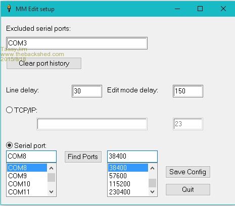

Posts: 6631
Posted: 09:38pm 17 Aug 2015
An update for WW and Grogster to test.
@WW
White space is also removed on lines with comments removed.
You might be happier with the wording of "Remove Leading and Trailing spaces"
#Grogster,
Still no idea why you are having problems with your "real" com port.
When you go to Connect/New...
There is an option add a list of com ports you want excluded from searches. The list needs a space between ports. eg "COM1 COM3". Remember to "save" before exiting.
This is handy if you have a modem or other device you want left alone.
Currently, you can still select the excluded port manually but I will probably stop that as well.
Below that is a button to clear all connection history.
I need to tidy up the layout a bit and update the help before releasing a full update.
2015-08-18_073526_MMedit.zip

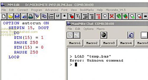

Posted: 07:55pm 18 Aug 2015
I've tried to use MMedit to send the simple program to a PIC32MX150F128B.see attached
If I use tera term it works ok.
If I try the same using MMedit the error msg appears when I try to send/prog.
As far as I can find there is no "temp.bas" file anywhere.
the program seems to load and save ok, but nothing keeps happening.
Help please
