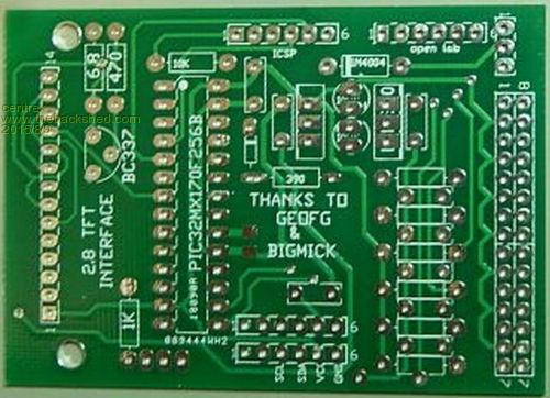

Hi All
As a fan of Bigmicks Bp170 I wanted something that had a few more features so I came up with this.
It only uses one smd for the special cap, it has a 12 to 5 reg if req, can have an OPEN LOG fitted to use SD cards, can be fitted with pull up resistors on the unused Pic 170 pins as well as bypass caps, I2C to suit RTC module.
$3 ea plus post if anyone wants one PM me.

Posted: 04:00pm 08 Aug 2015
Sweet Cliff..!
Is there a schematic to see..? What LCD display does it need..?
Looks like a nice PCB.. All through hole parts, easy for beginners to build..!
Nice...

Hi Zonker
The 14 pin tft spi lcd, it is the same as BigMicks BP170 with the extra bits, as you say all through hole except for the special cap req by the PIC chips.
Easy not only for beginners but those whose eye sight and steady hands that are no longer what they used to be (especially me).
Cliff

Posted: 09:57pm 09 Aug 2015
Hi Cliff,
A nice little board you have come up with.. I like the all Through Hole design (OK the VCap is SMD) it could be popular.
I think maybe you should consider another batch or two if there is sufficient interest. If you want to buy 20 PCBs with Shenzhen2U then place two separate designs that happen to be identical artwork this will ship for the same price as 1 order so you can save a bit on freight.
Congratulations on you first `commercially made' PCB
Also there was no need for any credit to me on the board but it flatters me... Peter and Geoff deserve all the accolades there.

  centrex said  . . all through hole except for the special cap req by the PIC chips.
Please note that there are through-hole 10uF ceramics available to make it 100% through hole. Even though this SMD component is easy to solder (as easy as a through hole), some people may still have a 'phobia' about this one component.
Can I propose that if anyone does make more of this PCB then to simply add in a through hole vCap instead. There is plenty of space on the PCB in the current position (and note that the caps are available in 0.1" and 0.2" pitch spacing).
WW

Posted: 12:34am 10 Aug 2015
@WW
OK on the through hole cap, I have added two via's at the smd location.
This would allow all through hole construction.
Have to see if there is any more interest before I put up the Gerber's or get more made.
Cliff

Posted: 07:01am 10 Aug 2015
I would be interested in one or two, and I'm pretty sure based on the
reception you got with the first accidental batch there will be
considerable interest. It would be my first MM.
It might help to give more of a description of the various connects,
although my questions were answered by carefully examining the photo
you provided.
I like the I2C pads; you almost can't get enough of them. In fact, if
possible, could another I2C row be added? My projects use sensors, and
they're almost all done with I2C, not to mention displays.
Thank you for your effort.
Hank

Posted: 11:51pm 13 Aug 2015
Hi All
Here are the gerber files for the board it has been updated a little the mounting holes for the display should now lineup, holes for the Vcap, the two power supply filter caps have been spread a little and the 12 to 5 volt reg moved to stop a bit of crowding.
2015-08-14_230322_lcd-bp170.zip
Use as you wish no strings attached all due care but any problems are yours.
It works well.
CliffEdited by centrex 2015-08-15
