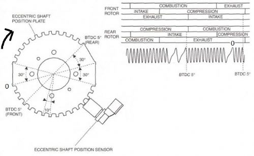

Everything will be based on the timing of the Crank Sensor (36-2-2-2). If this can be done, the rest should slowly fall into place. The imagine below is for a Rotary Engine. I have the hardware done that converts the AC sine wave into a nice digital signal. The fastest the engine will spin is 10,000rpm (166.6Hz)
First the engine needs to get in sync with the crank sensor and turn over until it hits the starting point (the missing teeth 0). I'm thinking I have to find the period in between the teeth, to know when I'm on a single tooth vs missing teeth. To setup the teeth in an array, I'd use the degree's (10 degrees per tooth).
tooth_deg[0] = 10;
tooth_deg[1] = 10
tooth_deg[2] = 10
tooth_deg[3] = 10
tooth_deg[14] = 10
tooth_deg[15] = 30
tooth_deg[16] = 30
tooth_deg[17] = 10
tooth_deg[18] = 10
tooth_deg[28] = 10
tooth_deg[29] = 30

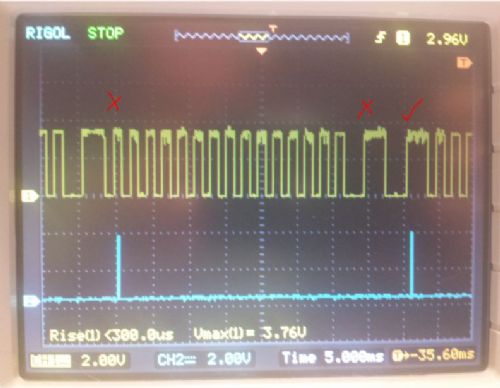

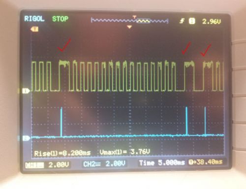

Software, I tried using 'TIMER' to capture the period of the previous signal, if the current signal period is longer, then I'm at a flat spot.
SetPin 1, INTH, tach
tach:
tooth0_time = Timer
tooth0_duty = tooth0_time - tooth1_time
If tooth0_duty > (tooth1_duty + 1) Then
Pin(2) = 1
Pin(2) = 0
End If
tooth_num = tooth_num + 1
tooth1_duty = tooth0_duty
tooth1_time = tooth0_time
IReturn
Attached 2 pics show it not reliable using TIMER, one rotation is correct and the other is off. I'm using another MM to generate the signal (so I can work at my desk and not in the garage).
Correct rotation.
The next rotation is off.

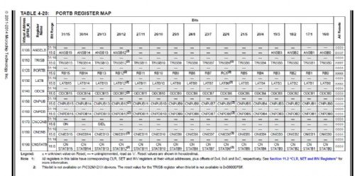

Is there access to the source code of MM? I'm trying to understand but find examples are easier to follow. I'd like to see how PULSIN is coded for example.
Reading the CFunction PDF, I can't seem to understand how the register map follows. Taking for the samples in the PDF.....
TRIS is the direction register if you want to make the pin Input(1) / Output(0). LATch is for writing, and PORT is for reading (for most situations)
//RB1
#define pgdout *(volatile unsigned int *)0xbf886114 = (1 << 1) // Trisb<1>=0 - Output
#define pgdin *(volatile unsigned int *)0xbf886118 = (1 << 1) // Trisb<1>=1 - Input
#define pgd LATBbits.LATB1
#define readpgd() ((*(volatile unsigned int *)0xbf886120 >> 1) & 1)
How does "0xbf886114" = B1? Wouldn't ...6114 be TRISB3 ? (1 << 1) gets me lost aswell.
LATBbits.LATB1 must be defined somewhere to address writing to LATB1 to keep a cleaner code. I wonder what else is defined? I did a search in plib.h header files but couldn't find the actual definition.
Same goes when reading the port, how does "0xbf886120 >> 1) & 1)" equal to 6121 (which I think is Port RB1)
//RB2
#define clklo *(volatile unsigned int *)0xbf886134 = (1 << 2) // pin 6 Low
#define clkhi *(volatile unsigned int *)0xbf886138 = (1 << 2) // pin 6 High
To me, isn't the base of latchB2 0xbf886132??
I'm sure it has something to do with me not understanding the offsets and virtual addresses.
  Quote  Every I/O module register has a corresponding CLR
(clear), SET (set) and INV (invert) register designed to
provide fast atomic bit manipulations. As the name of
the register implies, a value written to a SET, CLR or
INV register effectively performs the implied operation,
but only on the corresponding base register and only
bits specified as ‘1’ are modified. Bits specified as ‘0’
are not modified.
Reading SET, CLR and INV registers returns undefined
values. To see the affects of a write operation to a SET,
CLR, or INV register, the base register must be read.
All registers in this table have corresponding CLR, SET and INV registers at their virtual addresses, plus offsets of 0x4, 0x8 and 0xC
*Edit: Is there a better forum I should be asking the C questions on?Edited by MolsonB 2015-08-13

  Quote  How does "0xbf886114" = B1? Wouldn't ...6114 be TRISB3 ? (1 << 1) gets me lost aswell.
every register has 4 addresses
so, as an example, the base address of LATB (the output register) is 0xbf886130. If you write to this you set every bit on the port.
However, there is an address that allows you just to set individual bits. This is at the base address + 4
There is a register that just allows you to clear individual bits at the base address + 8
Finally there is an address that allows you to toggle individual bits as the base address + 0xC
so if I want to set bit 7 in the output of portB without changing anything else I just need to write 1<<7 to 0xbf886134
If I want to clear bit 5 I can write 1<<5 to 0xbf886138. Note that in this case I am writing a "1" to the address to clear the relevant bit.
The 1<<n notation is just an easy way of converting the bit number to a mask to pick out a specific bit. e.g. 1<<0 = 1, 1<<7 = 128
This approach exists for most registers so to change an individual port bit to an output we can just write to that bit in the port's TRIS base address +8
To make it an input write to the the port's TRIS base address + 4
Hope this helpsEdited by matherp 2015-08-13

Excellent, that is starting to make sense. I've only programmed human readable code, never this deep in C with registers. I miss that feeling of learning something new and all of sudden the brain clouds clear up and 'I get it' feeling.
Can I just clear up, reading the line in the legend is different then your offset Peter?
  Quote  All registers in this table have corresponding CLR, SET and INV registers at their virtual addresses, plus offsets of 0x4, 0x8 and 0xC
base + 4 is clear (clears value back to 0)
base + 8 is set (puts a 1 there)
base + C is invert (if it's a 0, toggles to 1. if it's a 1, toggles to 0)

Posted: 10:01am 12 Aug 2015
Absolutely correct, I got the set and clear the wrong way round
