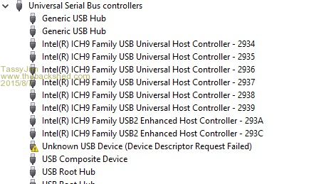

Posted: 08:03pm 06 Aug 2015
I bit the bullet and let my main PC upgrade to W10 Pro today.
Some more testing with the MicroMitePlus.
I have a diode in the USB power supply to stop back feeding and the Vbus pin connected to the USB side of the diode. This is the usual way of connecting them so the MM knows when USB is present.
Power externally then insert USB - OK
Reset with external power supplied and USB still inserted - error
Close TT, unplug USB and then reinsert with MM powered externally
Port appears OK in device manager but error with TT
Reboot PC with USB inserted and MM powered externally - error
unplug USB, reset MM, reinsert USB - OK
There were two error conditions. Windows looks happy in the Device Manager but TT hangs when connecting.
The other error give this in Device manager:
Not needing the Silicon Chip drivers is good.
Not being able to reboot the 'poota is a real worry.
For now I will get used to Unplug, press reset on the MM, reinset...
