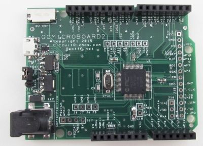

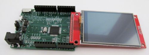

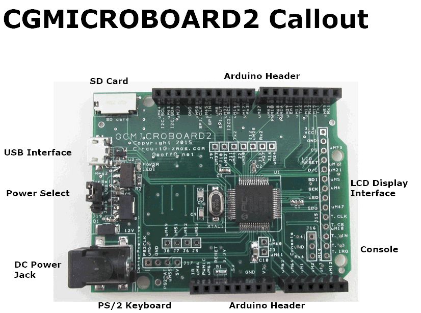

The CGMICROBOARD2 is a Micromite+ based Arduino-shaped board with support for the small serial LCDs.
You can stack most shields on the CGMICROBOARD2 and have LCD access either on the back or front (off to side).
Micromite+ signals were routed to the Arduino headers. There is a header for PS/2 keyboard and one for console. There are extra places to tap into remaining Micromite+ pins. There is also a micro SD socket.

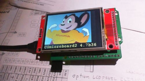

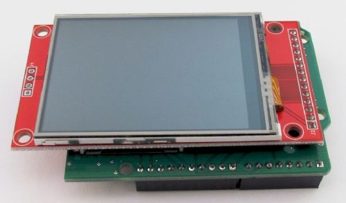

Posted: 04:58pm 06 Aug 2015
@Rob...
Yep... Works like a champ..! Display popped right on... I used that double sided sticky tape to keep the SD card socket shell from touching anything on the back side and "hard soldered" the unit in place... Sweet..!! Next, the SD card test and KBD test... Humm... I wonder if you can use the LCD console mode and bring up the editor...??? Will give it a go.. Yikes..! bed time...
Thanks Robert... Well done Sir..!!

  Zonker said   @Rob...
Well there we go! That looks great.
Console only works on larger displays, I think. Right?

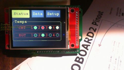

Posted: 02:40am 08 Aug 2015
Yep.. Your right on that one...
Anyway, Will be trying to connect up the LTC2983 thermo system to the board and start using it to run the "data gathering" part of the EIS project... I was going to do a setup menu thing through the USB port, but I think using the mini touch panel to do it is much less hassle for the end user... The starting GUI objects we have now should do the trick...
Thanks again everyone..! This MM+ stuff kicks butt and is easy to use for dummy's like me... (sweet)...

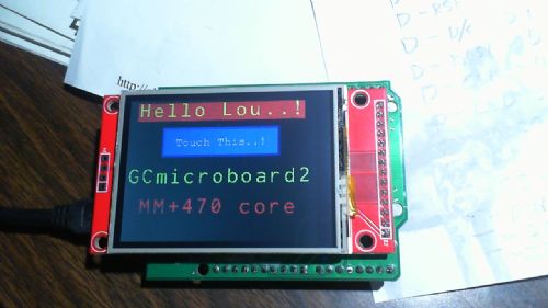

CG,
I received your boards a couple days ago, very compact, they look GREAT !!
Zonker is going to outfit one with a display for me to play with.
Thanks CG, thanks Zonker,
