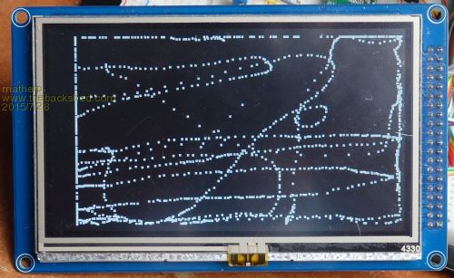

I've got a small issue re calibration of touch on the SSD1963. I'm calibrating with a stylus and accurately pressing and holding on the targets
On the 4.3" display when I use GUI TEST TOUCH, the spot follows the stylus nicely but won't go to the left edge of the screen
On the 5" display the the spot is correct on the left side of the display but progressively moves right of the stylus as I move across the screen. It remains correct up and down.
Has anyone else seen similar issues?
UPDATE
I've had a look at the code and am fairly certain there is a minor error in the commands sent to the touch controller. I've notified Geoff. Changing this will improve the touch resolution, particularly on the 5" and 7" displaysEdited by matherp 2015-07-29
