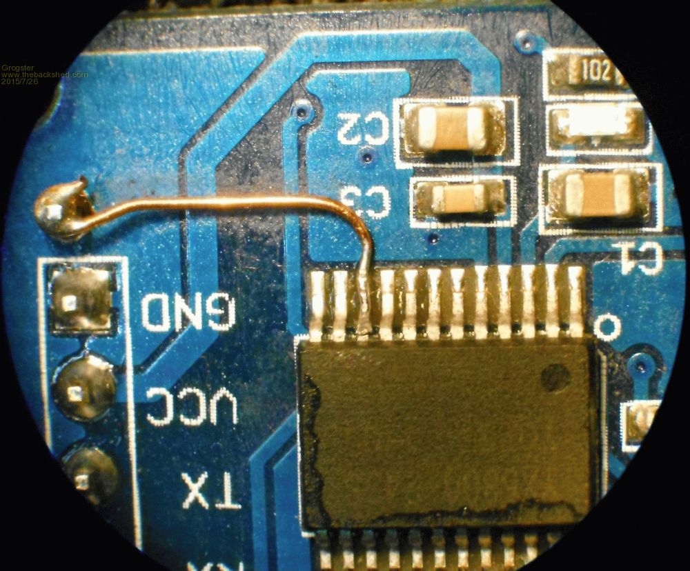

The Catalex MP3/WAV player module is an excellent unit for the price - a whole six bucks!
This one I have used in a few different projects and it is a very nice module and works really well considdering the price, and nice easy UART control.
However, this module lacks a BUSY pin, despite the 5300 decoder chip actually having such a pin - the designers of the module did not route this pin out to the header, for reasons I guess we will never know.
So I have hacked my one to provide this signal - only took about half an hour or so.
1) Remove existing pin-strip. I used Chip-Quik low melting point solder to remove the pin strip easily, but you could just lever up the little plastic insulator on the pin-strip, cut the pins, then remove the remaining pin with pliers and a hot soldering iron. Chip-Quik is neater though.
2) Mark the position for a 5th pin, and drill the PCB for this extra pin. Countersink both sides of the hole, to prevent the new 5th pin from touching the surrounding ground plane.
3) Install a 1x5 pin-strip, which restores the existing four connections, and adds one insulated one.
4) Add a very thin wire from pin10 on the decoder chip, to the new 5th pin on the pin-strip, and hey-presto!
You now have a BUSY line on the Catalex module, which goes low when any file is being played, and with that, your MM code can then detect when the module is busy or has finished playing a file. (this new BUSY line is normally-high)
Here is a photo of the mod from my microscope. The enamelled wire I used was 0.25mm

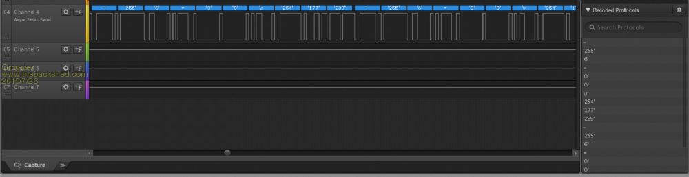

@ VK2MCT - The module does send data back on the TXD line, but the Engrish manual is very hard to follow as to the specifics of that, and the only manual I could find on the net for the 5300 decoder IC was all in Chinese. I ran it through google translate, and got a kind of English datasheet output, but it is still hard to understand a lot of it! The datasheet does suggest that it does send data back for various things, but I have never used the TXD line - I just send commands, and don't really care about what it sends back.
I might hook up my logic analyser to it's TXD line, and see what comes back on that line, for the purposes of experimentation.
Posted: 12:27am 26 Jul 2015

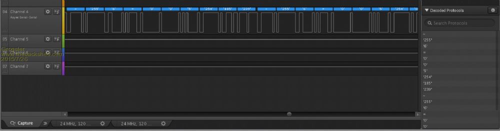

Yes, the module does definetly output several bytes at the end of each file played:
Three different files played, these are the bytes sent by the module at completion of playback, and the data is different for each one with the exception of the first few bytes of the message, which seem to always be the same.
I can't find any information about what any of this means though.....Edited by Grogster 2015-07-27

Felt a quicker busy line fix for the elderly like me, :-) may be to drill the extra hole in the same spot, run the insulated busy line from pin 10, through the hole to the top of the board.
Plug in your 5 way female header to the board, and push an extra male pin into the empty busy line, and solder the insulated wire to it. Very easy to disconnect if you need to do so.

@ Don: Yes, that is also a good idea. My photo was just how I did it. By no means the way you SHOULD do it - each to their own. On the other side of the board, is also just ground plane in that are of the IC, so you could do exactly as you say.
For all the times you are likely to be removing it, it would also be a great way to do the same.
In my case, I wanted the 1x5, so I could mount the PCB horizontally to a host PCB without having the MP3 module sticking up on it's orignal pins.
Again - depends on what the person needs!

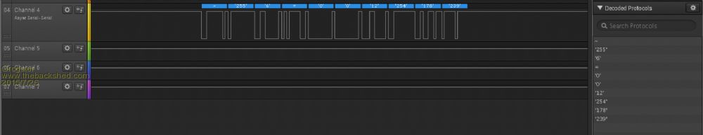

Here is a GIF of the output of the module in HEX as requested.
Note that this data changes with every file played, but the first few bytes seem to be the same. I must have a read through the manual that Rob found......
Catalex TXD GIF image example

I've done a fair bit of translating (google xlate) of the Japanese Manual
Manual example in HEX
7E FF 06 3D 00 00 02 xx xx EF TF card to play the first two completed
The GIF has (all hex)
7E_FF___________06__________3D_______00_00__0C_____FE_B2___EF
Std_start_chars___Bytecount___Command__?__?___Track__CRC_____Endchar
So this string seems to mean that the 0C th track has finished playing.
0C hex = 12 decimal.
So the 12th track has finished playing.
Could this be true ???

@ VK2MCT - Yes, I played track 12 for that test - well done, and that does correspond with the track I played for that test image last night.
