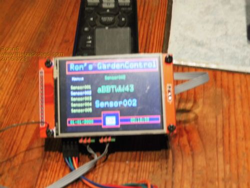

I am glad that my LCD Backpack of silicon chip finally arrived First I ported my menuesytem to mmbasich 5.1 every touch in the middle of the displays can kursor go to a furtherin this example is listening my RF module of the current CICECO kommunication it is a ciseco ERF module connected to COM 1 my picaxe make the fieldwork This example is intended for interested parties miss also the menue system
option autorun on
rem OPTION EXPLICIT
OPTION CLOCKTRIM -4
DIM menuep$(8)length 9
GeneralClock
settick 1000,GeneralClock
cls
CONST DBlue = RGB(0, 0, 128) ' A dark blue colour
COLOUR RGB(GREEN), RGB(BLACK) ' Set the default colours
FONT 1, 1 ' Set the default font
BOX 0, 0, MM.HRes-1, 40, 3, RGB(RED), DBlue'TopLine
TEXT 165, 18,"Ron's GardenControl", CM, 1, 2, RGB(CYAN), DBlue
BOX 0, 200, MM.HRes-1, 20, 2, RGB(RED), DBlue'Groundline
BOX 120, 180, 60, 50, 2, RGB(red), DBlue' OK Button
Open "COM1:9600,256,IntCom,8" as #1
sub IntCom
dateninp$=INPUT$(8,#1)
pause 50
msg$=datenInp$
text 170,100," ",CM,1,2,RGB(green)
text 170,100,msg$,CM,1,2,RGB(green)
rem print @(150,405)msg$
'if left$(msg$,2)="Te" then gosub Standart1 'DEBUG
if left$(msg$,2)="Do" then MessageBox
'if left$(msg$,4)="aBBH" then gosub Standart2 'DEBUG
'if left$(msg$,3)="aAC" then gosub Sensor1 'DEBUG
'if left$(msg$,2)="aB" then gosub Sensor2 'DEBUG
'rem elseif gosub sensor1 'DEBUG
'endif
close #1
Pause 25
rem Open "COM1:115200,256,IntCom,8" as #1
end sub
MenueStart
do
IF TOUCH(X) <> -1 THEN touched
LOOP
pause 100
end
SUB touched(MenueSel$)
LOCAL tx,ty
tx=TOUCH(X)
ty=TOUCH(Y)
if ty > 0 and tx > 0 then
if tx > 120 and tx < 170 and ty > 180 and ty < 220 then
text 150,210, "OK" ,CM,2,1,0,RGB(yellow)
pause 250
text 150,175, MenueSel$ ,CM,1,3,RGB(green)
endif
doitnow
endif
endif
END SUB
sub MenueStart
' Bildschirmmenü mit Scrollfunktion
local n:local i
text 40,60 ,"Menue",CM,1,1,RGB(white)
n=6 ' Total 6 Optionen
FOR i = 1 TO n -1
READ menuep$(i)
NEXT i
DATA "Sensor001", "Sensor002", "Sensor003", "Sensor004"
DATA "Sensor005"
rem cls
FOR i = 1 TO n - 1
text 50, (70 + 20*i),menuep$(i),CM,1,1,RGB(green)
NEXT i
a = 1
DO
text 50,(70 + 20*a), menuep$(a),CM,1,1,RGB(white)
DO
LOOP WHILE TOUCH(X) = -1
pause 100
text 50,(70 + 20*a), " ",CM,1,1,RGB(black)
text 50,(70 + 20*a), menuep$(a),CM,1,1,RGB(yellow)
IF TOUCH(X) <> -1 and touch(y) < 190 THEN
rem a = (a + n - 1) MOD n
a = (a + 1) MOD n
pause 100
endif
touched
MenueSel$=menuep$(a)
text 170,60,MenueSel$,CM,1,1,RGB(green)
loop
end sub
sub GeneralClock
TEXT 150, 210, "OK",CM,2,1,0,RGB(Cyan)
TEXT 50, 210, DATE$, CM :TEXT 250, 210, time$, CM
end sub
sub doitnow
SelOne=val(right$(menuesel$,3))
text 170,150, menuesel$ ,CM,1,2,RGB(Cyan)
select case SelOne
case 1
print #1,"Temp:Ret"
case 2
Print #1,"a--RELAYBTOGGLE"
case 3
MessageBox
end select
pause 250
end sub
Sub MessageBox
Local integer w
w = 100 ' get the width of the text (used for the box width)
' draw the box and the message in it
RBox MM.HRes/2 - w - 20, 60, w * 2 + 40, 130, , RGB(yellow), 0
Text MM.HRes/2, 70, msg$, CT, 2, 1, RGB(white)
Text MM.HRes/2, 100, "Attention", CT, 2, 1, RGB(white)
' draw the OK button
RBox 110, 140, 100, 40, , RGB(cyan)
Text MM.HRes/2, 160, "OK", CM, 2, 1, RGB(cyan)
' wait for the button to be touched
Do While Not (Touch(x) > 110 And Touch(x) < 210 And Touch(y) > 140 And Touch(y) < 180) : Loop
' draw the OK button as depressed
RBox 110, 140, 100, 40, , RGB(cyan), RGB(cyan)
Text MM.HRes/2, 160, "OK", CM, 2, 1, 0, RGB(cyan)
' wait for the touch to be removed
Do While Touch(x) <> -1 : Loop
watchdog 1000
' embedded fonts
' Font: Hom_16x24_LE
' Includes all ASCII characters
the c functions of fonds you have to load into the library
many thanks to the backsheedforum to share youre codes..
