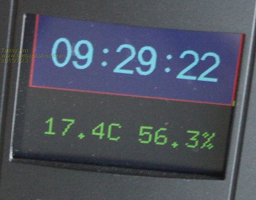

This is going to end up as part of my house monitoring system.
It uses the MX170, ILI9341 and DHT22 all tied together with a BP170 from Mick.
It will eventually have a lot more channels to display but for now there is inside temperature and humidity.
The top section is the clock which will disappear when I need the space.
Tapping the clock area changes the brightness - right for bright, left for dim.
The lower section is for temperature and humidity.

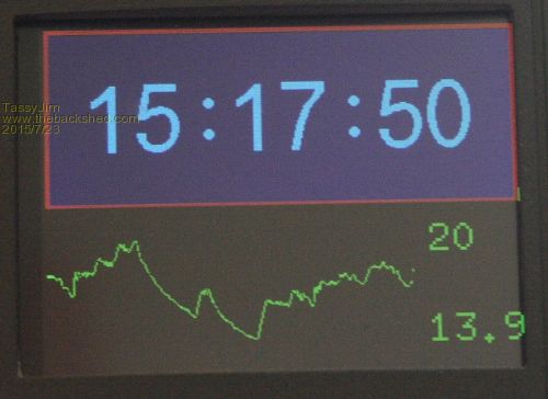

Tapping on Temperature will change the display to a graph of the last 24 hours.
Tapping again returns the display to current readings.
The same goes when you tap on the humidity.
The readings are taken every 30 seconds and the maximum and minimums are stored in an array every 6 minutes which requires a size of 4 x 240
240 is a good size for the graph when the display is in landscape mode. I will use 10 minutes (144 readings per day) if I end up in portrait mode.
The display in "Current reading" mode.
The display in "24hr" mode - numbers on right are max and min.

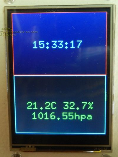

Here it is on a 2.8 TFT in portrait mode with the pressure havent got the averaging or the graph yet.
I will have to do a lot of careful study of Tassy's code to get that to work.
regards
Cliff
