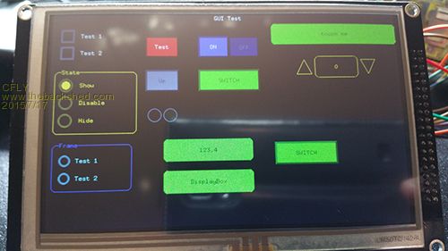

I have a screen 5 " from Sainsmart, I test it with the version MMBasic V4.7 B21.
Concerning display, no problems.
Concerning Touch panel ... not ok.
I loaded the program page 27 of the document "Micromite Advanced Features" with commands:
Option lcdpanel SSD1963_5, L, 1
touch option 14,21
gui calibrate command with the message in return " Warning: calibration was inaccurate. Recommend that it be rerun "
After start of the program, the display is OK but no reaction from touch panel !

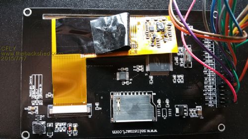

What chip is on that display, for the touch controller?
Needs to be resistive touch controller - capacitive controllers don't work, so I understand.....

When I execute GUI TEST TOUCH there is nothing on the screen ... => faulty panel
I am going to receive another LCD.

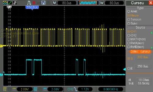

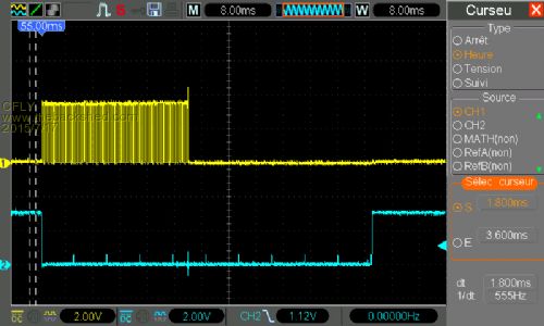

I have make the following connections (verified twice) :
T_IRQ : 21
T_DO : 47
T_DIN : 5
T_CS : 14
T_CLK : 4
SDO : 47
SCK : 4
SDI : 5
D/C : 27
RESET : 28
CS : 22
When I affect the screen the signals seem OK in the oscillo :
T_IRQ 1->0 and after 57ms T_CLK (50K) and data on T_DIN and T_DO ...
CFLY
Joined: 20/05/2015
Location: France
Posts: 41
Posted: 05:16am 17 Jul 2015
Blue : T_IRQ
Yellow : T_CLK
Blue : T_DO
Yellow : T_CLK
Posts: 12071
Posted: 05:39am 17 Jul 2015
Do you definitely have either a TSC2046 or XPT2046 chip on the display boards?
CFLY
Joined: 20/05/2015
Location: France
Posts: 41
Posted: 08:33am 17 Jul 2015
On ili9341 : xpt2046
On ssd1963 : ? No ref like tsc or xpt ...
Posts: 12071
Posted: 09:54am 17 Jul 2015
  Quote  On ili9341 : xpt2046
OK then this should definitely work.
Check again the connections T_DIN to SPI-OUT and T-DOUT to SPI-IN.
Can your scope do protocol analysis?
After T_IRQ you should see command &HD0 or &H90 transmitted on SPI-OUT and then two bytes received on SPI-IN. Then the other command will be transmitted and another two bytes received
Make sure when calibrating you maintain the pressure until the target disappears. Then release until the next target appears.
