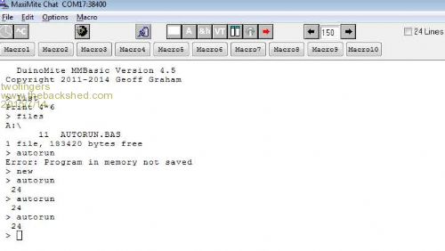

Posted: 10:52am 14 Jul 2015
  Quote  Does anyone else use MMEdit with v4.5 on a MaxiMite to try this out??
On a DuinoMite (4.5) all seems to work as expected ... nearly.
After a "NEW" I can execute "AUTORUN" on Drive "a:" repeatedly.
