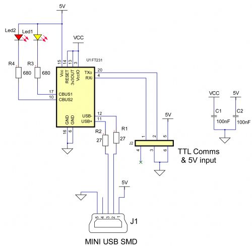

These chips all used an FTDI FT232RL chip, then Phil aka WhiteWizard put me onto another chip in the FTDI family (the FT231). The FT231 seems to be just as good as the FT232 but is in a smaller SSOP 20pin package instead of the larger (and fatter) 28pin FT232RL. The FT231 can be bought in one off QTY from RS-Components and Element14 for around $4AUS and RS offers free delivery.. Quite an excellent price for a genuine FTDI chip.. Hence MuP-TTL has come about..

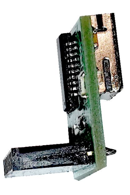

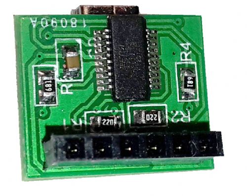

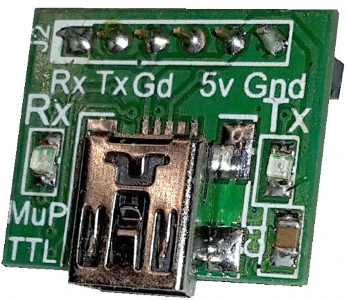

MuP-TTL is a small 19mm wide by 16mm high PCB that plugs directly into my `MuP-Standard' pinout header on MuP and BackPack170 PCB's. of course with a suitable patch lead it can be used as a general TTL adapter for any module. It is 3v3 TTL drive level but whilst it does pass 5V through to power MuP or BP170 it doesnt supply 3v3.
TOP
Bottom
Side
Schematic
With the chip being the most expensive component MuP-TTL can be built in about 30minutes and around $6 AUS total cost.. I will be offering a kit if anyone is interested at around $7-$8 or PCBs at $1 each (1 off) and less in QTY `blocks' This is less than the one off price for a genuine FT232RL chip itself.
All SMD parts are 0805 size (2mm x 1.2mm) including the 2 LEDs .. They are small and a little tricky to solder but really not super difficult.

NOTE! The Rx and Tx overlay for the 2 LEDs are swapped around.
I have checked and rechecked the datasheet and I must be missing something as the labelling is correct on my overlay as specified in the datasheet but the functions are reversed.. But as the pins that drive these (Cbus1 and Cbus2) are programmable I can only assume that the later driver configures these differently.. I will investigate that one further.

The Tx and Rx LEDs functionality are indeed reversed (Tx should be Rx and Rx should be Tx) as there are errors in The FTDI datasheet... They mentioned them twice in pin table descriptions and in both cases they have them reversed, The sample schematic in the datasheet has them correct though.. This is all detailed in the updated manual, probably available tomorrow morning.
