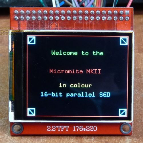

Here is a new display:
S6D1064 176x220 TFT display V1.0
Very cheap - e.g. this one
It is based on the S6D0164 controller and it needs a full 16-bit interface so why is it interesting?
Largely because it is by far the brightest and clearest TFT display I have found. For many applications you don't need the size and resolution of the bigger displays but you do need it to be visible. This one should be OK in even bright lighting conditions. It is, of course, very fast given a 16-bit interface and low resolution - a complete screen refresh takes just 22msec.
Full code, with description and comprehensive example, is in the ZIP
2015-06-28_183136_s6d0164.zip Edited by matherp 2015-06-29

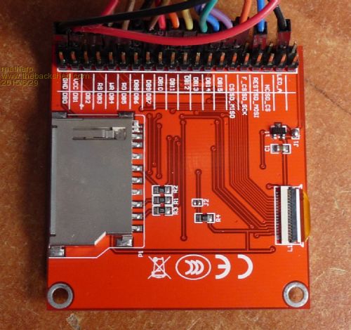

You need to set the display to either 8 or 16-bit operation. This is done with the shorting jumper J2. Open is 8=bit, closed is 16-bit. Also I make the J1 jumper to bypass the regulator as we are running 3.3V for the Micromite
Here is a version of the code that will run in 8-bit mode. Please note that in 8-bit mode you must use connections DB8-DB15 and not the lower inputs which you may expect. With only an 8-bit databus this version will run easily on the 28-pin part with completely flexible pin allocation but it also contains optimisations that will automatically let it run faster on the 44-pin Micromite using pins 26,26,27,36,37,37,2,3 for DB8-DB15 respectively. If these pins are used the code also supports fully flexible scrolling of a sub area of the screen. Pins 4 and 5 may not be used if the 44-pin processor is wired for the optimised pinout.

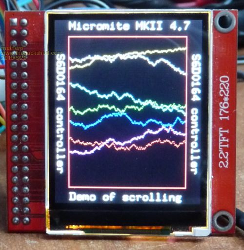

S6D0164 8-bit V1.2
I really like this display, it is so much brighter than any of the others I've tried, ideal for all sorts of instrumentation.
In this release I have removed the restrictions of pin usage so all functionality will now work irrespective of the pins used to connect to the processor. This means it will work as well on the 28-pin MM2 as the 44-pin. The absolute speed of update is slightly reduced but because the display is relatively low resolution the usability is not impacted.
The parameters to the triangle drawing routine remain unchanged, however, I have changed the triangle drawing Cfunction to accept an array of coordinates. This allows the routine to be used for drawing the gauge with the needle updating smoothly. The gauge code is now included in the demo as well as the scrolling multi-line plot
The code is attached:
2015-07-02_073225_s6d0164-8.zip
Please note I don't intend to further develop the 16-bit parallel bus routines for this display. It works perfectly well with an 8-bit bus and the reduced pin count makes it much more usable in many applications
If you really need more speed then just replace the Cfunction with the version below. Note in this case you must use a 44-pin MM2 and pins 25,26,27,36,37,38,2,3 connected to DB8-DB15. In this case pins 4 and 5 may not be used.

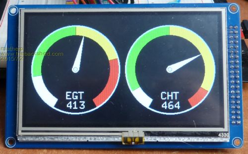

SSD1963 V4.1
4.1 Automatic selection of optimisation removed to reduce CFunction size
Optimisation selectable by commenting/uncommenting relevant version of CFunction
all functions, including scrolling, available with any pin allocation
Changed triangle drawing CFunction to accept an array of coordinates
Dual Gauge added to demo code

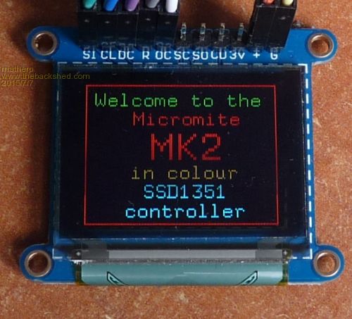

SSD1351 V2.0
Converted to 4.7 compatible calling sequence and use of internal fonts
2015-07-07_095612_ssd1351.zip
Things to note:
The code is only tested on a 128x96 version of the display but should also work on a 128x128 - feedback appreciated. The vertical resolution is set in the call to S1351.init
Due to the way the 96 line display addresses there is a limitation on changing orientation within a program. All orientations work properly if used by themselves.
You can also change flexibly between PORTRAIT and LANDSCAPE (or RPORTRAIT to RLANDSCAPE) within a program and everything will work properly. i.e. you can draw something in PORTRAIT and annotate it with text in LANDSCAPE before reverting back to PORTRAIT.
However, if you try and mix between the pairs strange things happen. So if you draw in PORTRAIT and try and annotate with text in RLANDSCAPE the things drawn in PORTRAIT will move on the screen when applying the text and visa versa.
I suspect this limitation will not apply if using a 128x128 display but again feedback would be appreciated

@Matherp...
Good evening Peter.. The 2.2" TFT 176x220 Display units got here today... I programed up a 28 pinner with v4.7b8 and downloaded your program that uses the 8 bit interface... Out of time tonight, but should have it wired up tomorrow.. One question if I might... What value of current limiting resistor should be used for the LED back light..? I will be running the display on 3.3v (solder blob on J1) I was thinking 18 ohms, but not sure... What would give MAX brightness without decreasing the life of the back light..?
Thank you for you time fine Sir..!
