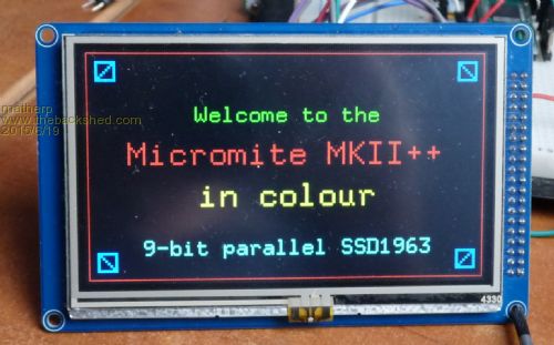

See the Youtube video for an idea of the performance achieved.
With the new facilities Geoff has included in 4.7b8 it is possible to make significant improvements to the code to drive displays other than the ones directly supported. I must also thank Peter Carnegie (G8JCF) who is creating, testing, and documenting the mechanisms to call internal Micromite firmware functions from CFunctions. Without his work this development wouldn't have been possible.
In this case, I have updated the code for the 44-pin MX170 to drive the 4.3", 5", and 7" SSD1963 displays.
I did more research on the SSD1963 and found a mode in which the colours can be loaded as two 9-bit parallel data elements. This supports RGB666 which gives better colour resolution than the RGB565 used by other displays.
The advantage of the 9-bit mode is that the 44-pin MX170 has 10 data pins on port C which do not overlap things like I2C or SPI. These connect to the 9-bit data bus and to the WR pin which is used to load the data on the bus.
pin set up allocation is:

Note the display only uses 12 pins on the processor. Pins DB9-DB15 on the display can be left unconnected.
The code now uses the same in-built fonts as the directly supported displays and uses the same 24-bit colour codes (e.g. rgb(red))
All of the facilities are included in the demo code shown in the youtube video

The code has been tested on the 4.3" (480 x 272) and 5" (800 x 480) displays. I haven't got a 7" display. You will see in the code there are a number of "IF" statements that set up the display size. These can of course be simplified for a single size display.
I'm very pleased with this version - it allows the use of the larger displays on the MX170 and gives very good performance.
