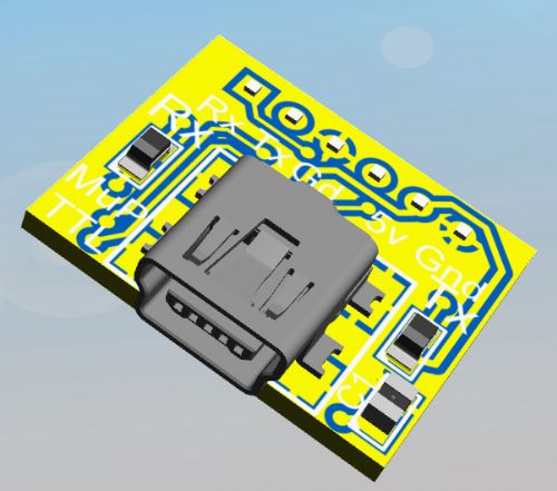

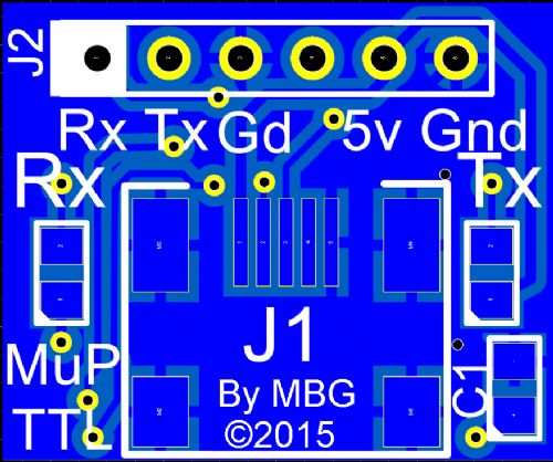

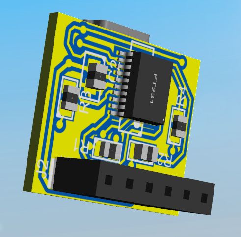

Only this afternoon I just sent off to get made 2 more boards using the FTDI FT231-XS chip.. These are only $3.xx each in one offs locally by RS components or Element14.. and as they are REAL FTDI chips they should work OK..
One board is a small 19mmx16mm (0.75"x0.63") pcb that supplies 3v3 TTL level serial from a USB Mini input. The output is in a pattern that plugs into my MuP standard..
3D Top and Bottom
