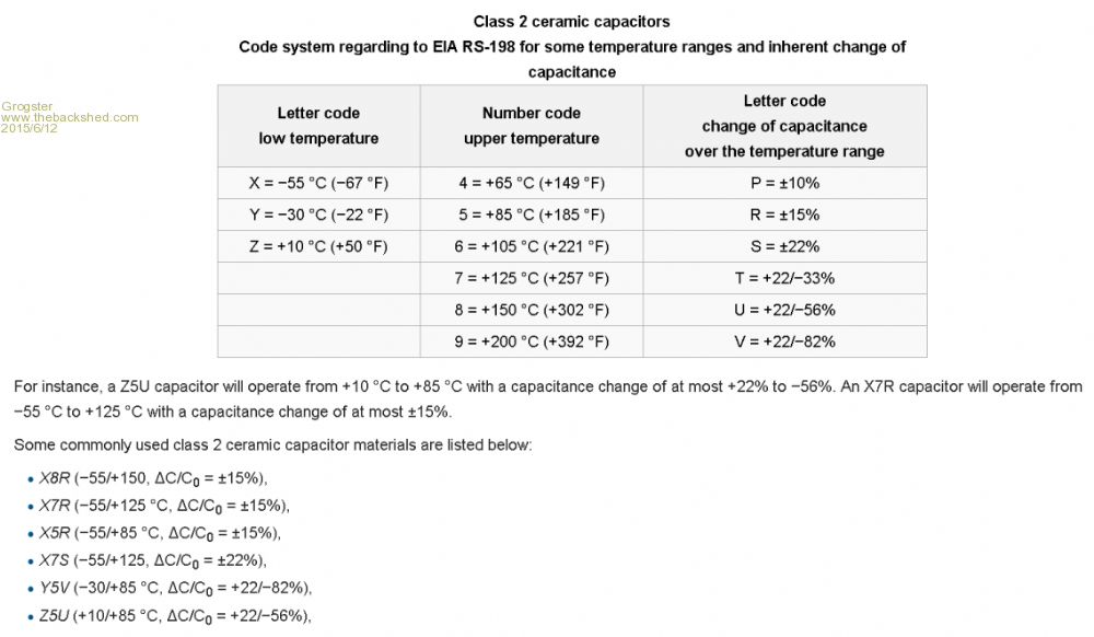

The ones I use are X5R type, and this is the minimum spec. X7R are fine too, as mentioned by akashh, and X7R actually have a higher stability at high temperatures then X5R, but for use with the MM, X5R is fine - either will do.
DO NOT use cheap ceramic caps(X7S, Y5V, Z5U) for Vcap, as this cap is critical to the stability of the PIC32 core.

EDIT: Here is a chart to help you choose the right cap characteristics:
Edited by Grogster 2015-06-13

Don't get me wrong - nothing bad about akashh's suggest of X7R. It would work fine, but as it is rated for a higher temperature, which you won't be exposing the cap to when used with the MM, then paying the extra for X7R is, IMHO, a waste of cash.
Note how if you were using something like Y5V, then the cap can vary in capacitence up to 82%!!! That is a hell of a lot!!! Yes, it is proportional to the ambient temperature the cap is exposed to, but that still represents a huge amount of change.
