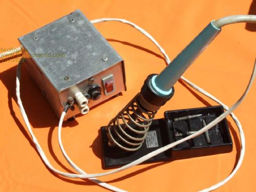

  robert.rozee said   the base unit is just a 24v transformer, nothing more. so if you see a handle on its own going cheap, grab it.
This is a picture of my nearly 40 years (!) old Weller iron. I'm happy with it and I never had to replace anything.
