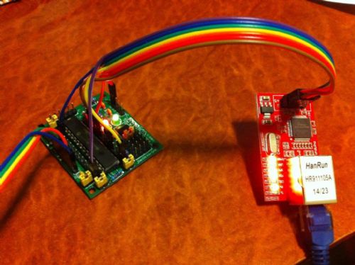

Here is the beginnings of a library for TCP/IP support on the Micromite using the Wiznet W5100 module - readily available cheaply on eBay, eg:
eBay listing for Wiznet W5100 module
This library of functions and subroutines has support for TCP server and client with an example of both. It could be used to run a small embedded webserver, or post measurements to a webserver periodically.
Receiving data from the Wiznet is a bit slow - byte by byte over SPI. It would ideally be rewritten in C if better performance were required. Although, I don't expect many embedded applications would require much in the way of data transfer - short messages periodically only.
The datasheet for the Wiznet W5100 module is available from here (there are later versions around if you search, but figured this should be a reliable link to publish):
W5100_Datasheet_v1_1_6.pdf
There is no DHCP support, only static IP address - the Wiznet W5100 doesn't support DHCP but you could add DHCP support to this library in MM-Basic.
Hope it's helpful to somebody.

I've written some brief documentation for the Micromite Wiznet W5100 Library, see below.
David
2015-06-07_212241_micromite_wiznet_library_David_and_Jacqui's_Wiki.pdf

I found the Guidelines for Creating Libraries for MMBasic over here and have updated the Wiznet W5100 ethernet module MM-Basic library accordingly. I also fixed a few things, made some improvements and added UDP support.
2015-06-15_193612_micromite_wiznet_library_2015-06-16.pdf
Example Webserver:
' Wiznet W5100 Micromite Examples
' Hardware Connections
' | Wiznet | Micromite |
' | Ground | Pin 19 |
' | +5V | +5V |
' | RST | Pin 23 (Wiznet W5100 Reset) |
' | SS | Pin 15 (SPI Slave Select) |
' | CLK | Pin 25 (SPI Clock) |
' | MO | Pin 3 (SPI MOSI - Master Out, Slave In) |
' | MI | Pin 14 (SPI MISO - Master In, Slave Out) |
' | Gnd | not used |
' | PoE+ | not used |
' | PoE- | not used |
Option explicit
Option base 1
dim ip1%, ip2%, ip3%, ip4%
Dim example$
Dim txstring$
Dim curLineBlank%, curFirstLine%
Dim char%
Dim firstLine$
Dim i%
Dim conversationStart%
' Call with pin used for Wiznet Reset and SPI Slave Select of Wiznet:
WN.Init 23, 15
' Set a pin as analog input for testing webserver
SetPin 26, ain
' Set up the IP address to use
ip1%=192
ip2%=168
ip3%=1
ip4%=65
' Set static MAC address/IP address/subnet mask/gateway
WN.SetMAC &H00,&HFE,ip1%,ip2%,ip3%,ip4%
WN.SetIP ip1%,ip2%,ip3%,ip4%
WN.SetMask 255,255,255,0
WN.SetGateway ip1%,ip2%,ip3%,1
WN.Start ' Sets various internal registers for Wiznet
If WN.SockClosed(3) Then
If WN.SockTCPInit(3, 80) Then
Print "Socket initialized on local port 80"
Else
Error "Failed to initialize socket"
End If
If WN.SockTCPListen(3) Then
Print "Server is at "+WN.GetIP$()
curLineBlank%=1
curFirstLine%=1
firstLine$=""
conversationStart%=0
Else
Error "Failed to listen on socket"
End If
End If
Do While WN.SockEstablished(3)
If conversationStart%=0 Then conversationStart%=Timer
For i%=1 To WN.sockData(3)
char%=WN.sockRead(3)
Print Chr$(char%);
If char%=&H0D Then
If curLineBlank%=1 Then
Print firstLine$
WN.SockWrite 3,"HTTP/1.1 200 OK"+WN_CrLf$
WN.SockWrite 3,"Content-Type: text/html"+WN_CrLf$
WN.SockWrite 3,""+WN_CrLf$
WN.SockWrite 3,"<!DOCTYPE HTML>"+WN_CrLf$
WN.SockWrite 3,"<html>"+WN_CrLf$
WN.SockWrite 3,"<h3>Micromite Webserver</h3>"+WN_CrLf$
WN.SockWrite 3,"<p>Pin 26: "+Str$(Pin(26))+" volts</p>"+WN_CrLf$
WN.SockWrite 3,"</html>"+WN_CrLf$
WN.SockClose 3
End If
End If
If char%=&H0D Then
curLineBlank%=1
curFirstLine%=0
Else If char%<>&H0A Then
curLineBlank%=-1
If curFirstLine%=1 Then
firstLine$=firstLine$+Chr$(char%)
End If
End If
Next i%
If conversationStart%>0 Then
Print "Time: "+Str$((Timer-conversationStart%)/1000)+" seconds"
End If
End
<include library here>
Browse to http://192.168.1.65/
2015-06-15_193929_Webserver_and_UDP_Examples.zip

Posts: 2981
Posted: 12:27am 16 Jun 2015
OMG David,
I wish you didn't create this monster ...
Look what I have gone and done now.
http://mickls.gotdns.org/
PS.. I love it... now to see a list of commands that this module can do... I have had to scrape the last few brain cells from the bottom of my skull to find the correct syntax to display links and pictures etc.. but in a relatively short time... Hey I have a web-server (Almost)
And running on a MicroMite to boot.
Mik

Here is a multi-page webserver example:
' | +5V | +5V |
Option explicit
Option base 1
Dim ip1%, ip2%, ip3%, ip4%
Dim example$
Dim txstring$
Dim char%
Dim firstLine$
Dim i%
WN.Init 23, 15
SetPin 26, ain
ip1%=192
ip2%=168
ip3%=1
ip4%=65
Else
Print "Failed to initialize socket"
End If
curLineBlank%=1
curFirstLine%=1
firstLine$=""
Else
Print "Failed to listen on socket"
End If
End If
Print Chr$(char%);
If char%=&H0D Then
Print firstLine$
If Instr(1, firstLine$, "?on") Then
SendHeader
WN.SockWrite 3,"<h3>Lights turned On!</h3>"+WN_CrLf$
SendFooter
Else If Instr(1, firstLine$, "?off") Then
SendHeader
WN.SockWrite 3,"<h3>Lights turned Off!</h3>"+WN_CrLf$
SendFooter
Else
SendHeader
SendFooter
End If
End If
End If
If char%=&H0D Then
curLineBlank%=1
curFirstLine%=0
curLineBlank%=-1
End If
End If
Next i%
End If
End
Sub SendHeader
Sub SendFooter
WN.SockWrite 3,"<p><a href='./?on'>Turn lights On</a> | "
WN.SockWrite 3,"<a href='./?off'>Turn lights Off</a></p>"+WN_CrLf$
WN.SockClose 3

GDay All,
David has done a pretty good job with his library to the WizNet board..
Now the following could be pretty boring to those who already know this but I post it to maybe assist others get their own WizNet boards live on the net..
Lets get a whole heap of them going around the world..
The above was done fairly simply by looking at HTML code and playing with it in Daivds WN.xxx syntax. I know nothing at all about HTML code and whilst the command syntax is not quite exact it is very close and is basically the " marks in different locations.
I have attached the basic code here if someone was interested in setting up one for them selves.
2015-06-18_225341_mick_webserver_v1.bas.zip
You need to set up a STATIC IP for the WIzNet board (defined in lines 45-48) this should then work on your local network, set these to suit a static IP on your network.
To get the WizNet board to be seen on your WWW network you need to set your Modem/router to `port forward' requests to port 80 through to the IP address of the WizNet module... There are heaps of tutorials on how to do that if you consult Dr. Google.
Now WizNet should be able to be seen externally by using your `real world ISP assigned IP address' in my case (you will have your own set of numbers... Goto myip.dk to see what yours is set to) this, for me, is currently 120.144.191.64 so you can just enter those numbers into your browser from anywhere in the world..
Now, as is the case for me this real world IP can and does change from time to time (such as a restart of my modem or a loss of power etc) so that is where a site like DYNDNS.ORG can help.. you can apply for an acct with them (I think its about $10 per year) which gives you a `pseudo domain name' and then you run a `ticker' on your PC (a small file that sits on your pc to periodically tell dyndns what your ISP assigned IP is and dyndns will update its records and assign your IP to your domain name.. in my case its mickls.gotdns.org so you never need to know what your IP actually is as it all happens in the background.
All that aside my WizNet setup is locking up from time to time, I dont know why, but it seems to be once per day.. I reckon I need to setup a watch dog timer to reset in the event of a lockup/error.
I am going away for about 2 weeks on the weekend so mickls.gotdns.org will probably be offline until I get back.. I may leave it going if I can get a watchdog going.
EDIT***
I have added a watchdog timer to hopefully catch any lockups etc..
If it looks stable I will leave it up whilst I am away.
Edited by bigmik 2015-06-20

Hi All,
I have still been experiencing lock ups with my uMite Powered WizNet board..
After consultation with David, he thinks it may be the SETTICK routine is interrupting the SPI communications with the WizNet board..
I was trying to show a `real world' situation where you could remotely read the status of various pins.
Goes to show why I shouldn't be allowed near a programming console and should stick to my soldering iron..
In any case, I have modified the code to use Pin(26) as a PWM 20Hz 50% output and read this in on pin(2)..
Please test Mickls `Wiz-Bang' Server and let me know if it falls over.
If it does fall over I will put it aside until I get back from Overseas (Fiji)..

Posts: 2981
Posted: 06:15pm 19 Jun 2015
Nope!
Stopped working again...
I am pulling it off air until I get back.. It is most likely something I did adding to David's code.. I really am a lousy programmer so it isn't my expertise...
Anyway I will go and have a 10 day long hangover and get sunburned in Lovely Fiji and forget the cold of Melbourne's Winter....
