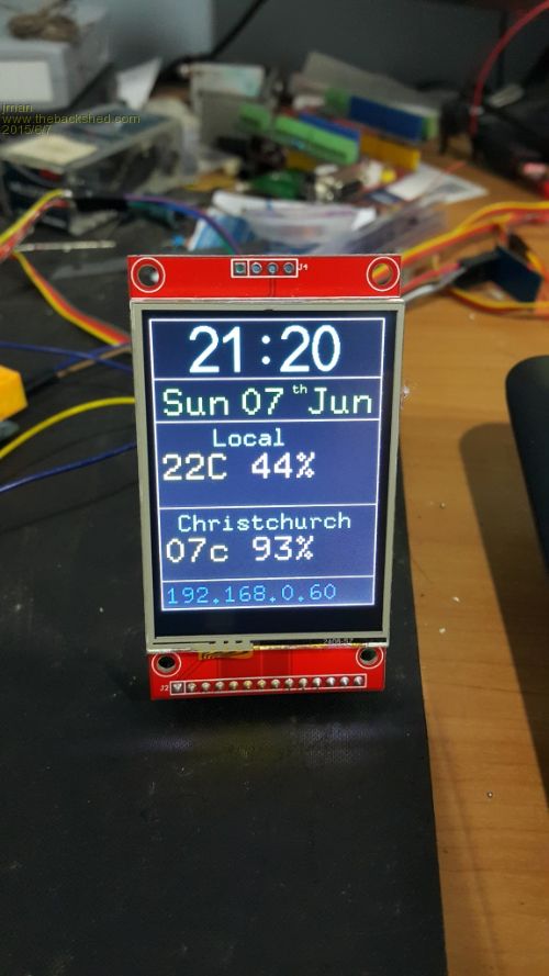

The local temperature and humidity is done with a DHT22
The date time are parsed from the web data as is the temperature and humidity
As you can see by my poor screen design I have zero artistic flair
So now for the BIG question who's up for a joint effort to design a nice
looking couple of screens with relevant info displayed.
We can use touch to toggle between the different screens.
Maybe bitmaps for static parts of the screens ?
All thoughts ideas help of any kind would be greatly appreciated

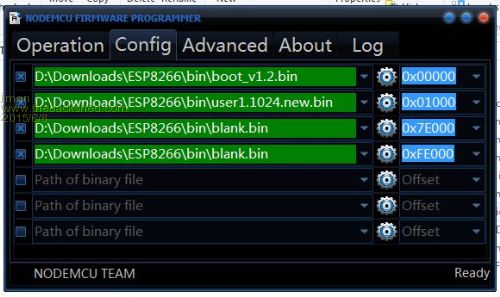

Here is a screen shot of the Flasher config tab
JohnEdited by jman 2015-06-09

I've been chasing around the NodeMCU site for any sort of User Guide for the ESP8266 'Flasher'. I couldn't find anything obvious so set it up anyway at 115K2 and pointed it to the files as per your config screen above. Pulled GPIO0 low and powered it and the two MAC addresses appeared immediately. I then hit the 'Flash" button and a couple of seconds later the ticked green box appeared at the bottom.
That seemed awful fast and I wasn't convinced anything had happened so powered down, disconnected GPIO0, connected TerraTerm and tried an AT+GMR command. This came back with the '0018000902-AI03' response which I think is what used to happen with the Electro Dragon 0.922 firmware. Now I'm not sure what I've got. What should the Version response be your setup?

Posted: 09:21pm 09 Jun 2015
@Greg
Don't forget the little tick box's on the left of the config screen

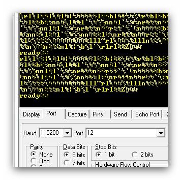

Rats! after just getting the ESP8266 going with the updated firmware I think I might have killed the Rx input on the ESP8266. Can someone tell me an easy way to check this out?
I'm using a 5v USB>Serial converter with a current limiting 1K resistor in its transmit line. This has always worked fine in the past for this module and for all the Micromite console work but now I can't get TerraTerm to send anything to the module, i.e. nothing 'echoes' back to the TerraTerm screen and there's no response back from the module.
I think the module's Tx is OK because if I cycle it's power a heap of 'rubbish' comes back to TerraTerm as it has in the past. I checked the serial converter by connecting it to the MicroMite and that's working fine as before so it's OK. I've tried all the usual baud rates, just in case, but no difference.
