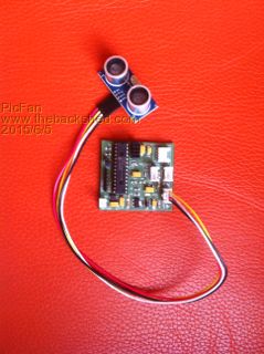

I have a problem with the "distance-command" with V4.7B3-8, i read only 0.4 again. With the Version 4.6 the "distance-command" works perfect.
Thank you !
Wolfgang

I use the same PCB and the same hardware, i change only the PIC !
trigPin = 17
echoPin = 18
DO
dst = DISTANCE(trigPin, echoPin)
PRINT dst
PAUSE 1000
LOOP
Thank you !
Wolfgang
