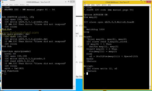

About to embark on a major project using bigmick's I/O boards so decided to set up the I2C example from the MicroMite manual (4.5).
Typed in the example code to two MM's running 4.6
I hope the images are clear enough thought this was best way to show both Master (left) and slave (right).
This code is functionally identical to the manual (well except for the commented out print statement in the slave code).

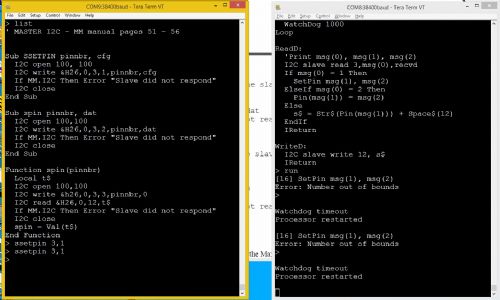

If I then run the slave and type the ssetpin command into the master I get number out of bounds error from the slave and a reboot of the slave. :-

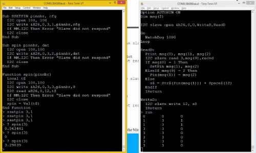

Now if I uncomment the print statement which I inadvertently put before the I2C Slave read things work as expected. It seems to me the slave read does not handle the array correctly.

Try putting a delay at the start of the ReadD sub.
The sub is called as soon as there is some data available but it takes time for the rest of the data to arrive.

I can confirm that your code, as taken straight out of the manual, fails as you indicate on line 14.
It appears that the variable cfg in the slave which is supposed to be setting the pin as a digital out (8) is actually being received as a 0 (I put a print statement prior to line 14 to give the pin and config info)
This could be a timing issue in that the cfg parameter doesn't arrive quick enough - haven't been able to check that yet.

I can confirm that a pause 10 will overcome the issue.
